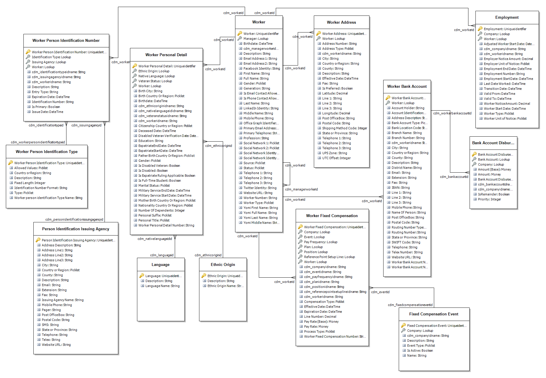

    Typically the manager field should be populated in the worker entity in the CDS, see https://docs.microsoft.com/en-us/dynamics365/unified-operations/talent/media/hcmcommon-worker-entity-diagram.png
