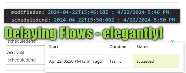

Have you tried the Delay Until option of the Dataverse trigger in Power Automate? If not, I will show you some useful knowledge about that field, variations of usage and a workaround.
For the story: We want to send out a notification when the Due Date (scheduledend) of a task approaches. Hitting the correct timing is possible in many ways, but Delay Until can be very elegant!
Using Delay Until Trigger
If you just have a simple field that marks the execution time, it’s simple, just enter the logical name. If it’s more complicated, you are out of luck at first, since you cannot use any outputs of the trigger for calculating the delay in an expression. We will try to cover that in the next sections.
The trigger only reacts to changing the Due Date and waits for the Due Date before the execution starts.
The change was made at 5:46, target time is 5:50. The flow run appears at 5:50.
