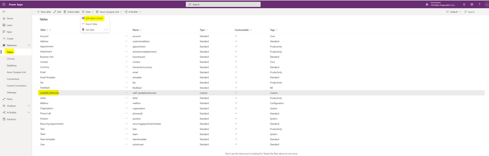

That said, I navigate to https://make.powerapps.com and under Data/Tables, I create a new custom Dataverse Table. I create this new custom Dataverse Table so I can save the information processed in table tailored for our needs.
See below the Dataverse/Tables form:
I create a new table by clicking "+ New table" and add information required.
After confirming, the columns form appears. Some standard fields have already been created at time of table creation by default. However, I still require our custom fields to be created. To do so, we leverage the "+ add columns" option.
I added the following fields/columns:

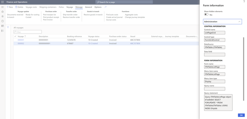

I found the correct table name in Dynamics 365 for Supply Chain Management under Landed cost/All voyages. Under right click/form information, I can see that voyages are housed in the ITMTable.
Under options/Record info and show all fields on the Actionpane, I can also identify the tableID.

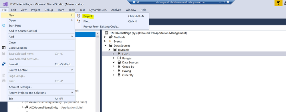

After my RDP session to my VM is established, I open Visual studio 2017 as admin via right click/run as admin.
I sign in with my visual studio account and navigate to view/application explorer.
Under application model, I navigate to Data model/tables and search for ITM Table.
I right click the table and open the table in tablebrowser to see data currently maintained in the ITMTable in case I want to validate that I capture the right table.
Lets take a look at the entity - As you can see there is no entity available herefore yet. So, I need to create a custom entity.
I created a new model.
I created a new project and chose FO project and a name accordingly.

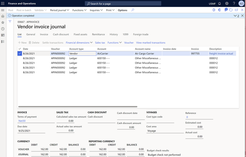

- Create Vendor Invoice journal
- Add line with total invoice cost
- Click voyage in Actionpane
- Distribute/Allocate actual costs per specific charge
- Confirm
After the recording is completed, I click finish and save - See the result below:

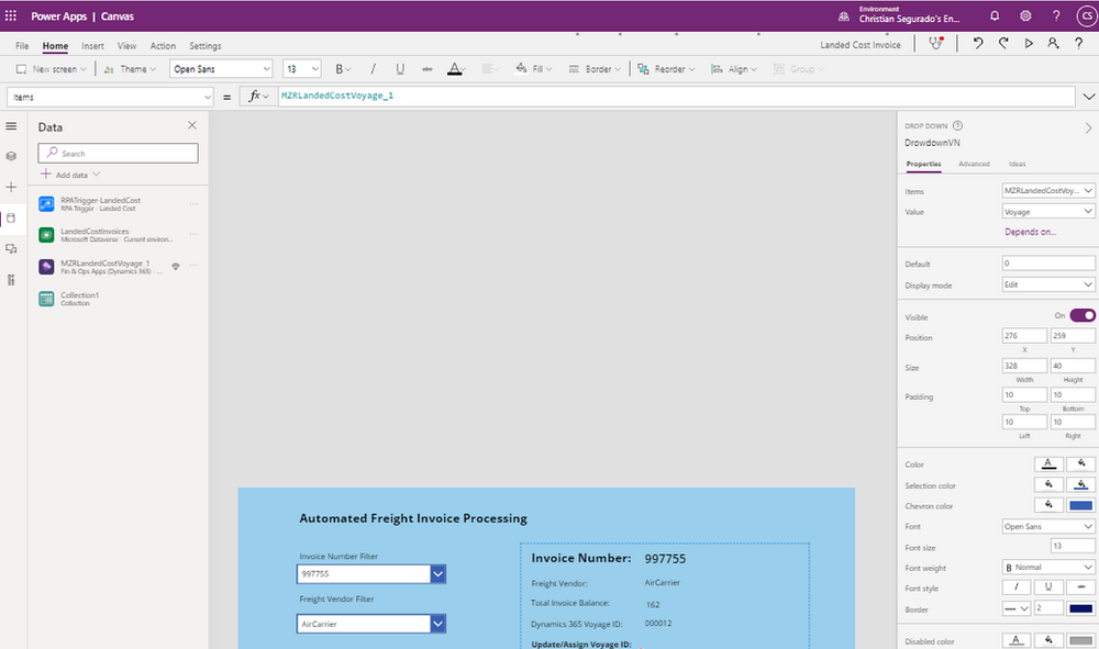

As a next step, I configure the instant flow that I reference in my PowerApp later and that will trigger the above set up PowerAutomate Desktop agent to run and passes values from Dataverse on to the Desktop agent.
6. Configure PowerAutomate instant flow for RPA processing
I configure an PowerAutomate instant cloud flow that will be triggered by a PowerApp. The flow should be able to get information from Dataverse and pass them on to the PowerAutomate desktop agent and kick of the RPA bot.

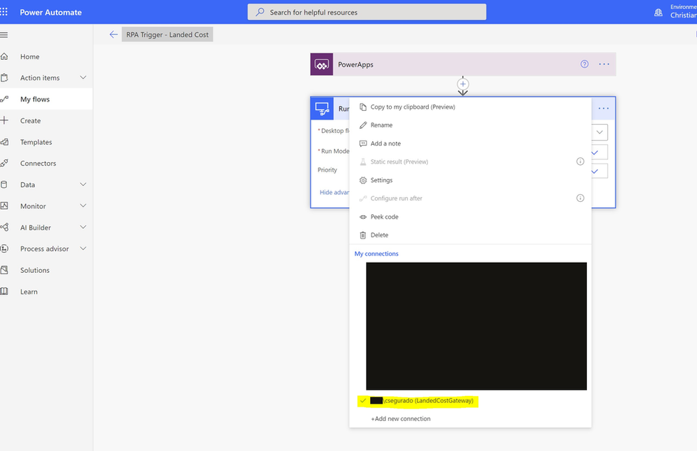

I add a new step and select "run a flow built with Power Automate Desktop". This is a premium action as you can see.

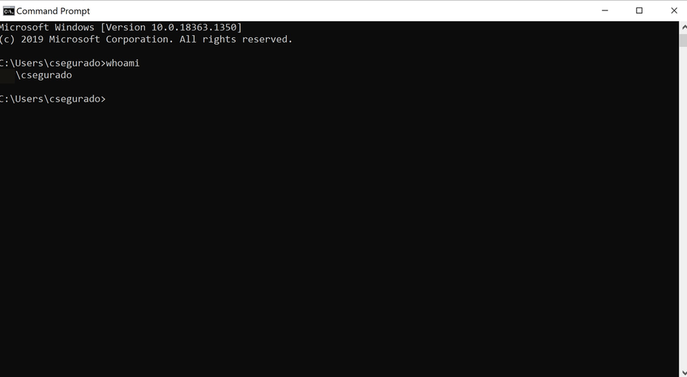

As a next step, I add a new gateway for on prem connection - it downloads a file that you need to install on the machine where you want to run the RPA bot from. (here: my local machine)

That said, I navigate back to PowerAutomate and you can see now that the gateway that I just created can be selected.
I select the "LandedCostGateway" in the gateway name field. As a next step, I identify the domain name of my local machine.
I open the command panel and type in "whoamI" and my domain will be shown. I enter that domain and my password and lastly confirm.
After doing so, the connection is established.
As a next step, I select the PowerAutomate desktop flow that I created/recorded earlier. (Here: "LandedCostInvoiceProcessing")
I specify "attended" as run mode. I still need to pass on the correct values from Dataverse for a specific invoice. To do so, I add a "Get a row" action prior to the "Run a flow with Power Automate Desktop" action to make sure we pass on the values from a selected record in the gallery of a PowerApp.
As a next step, I reference the specific variables/fields (also named columns) from Dataverse to be passed on to the PowerAutomate Desktop agent.

I navigate to https://make.powerapps.com/ to create and configure my PowerApp. The PowerApp should be able to filter invoice records from Dataverse and show results in a gallery. It should also be able to patch the D365FO voyage number to the selected Dataverse invoice record (this is required as the RPA bot needs to know the D365FO voyage number to process received freight invoice information in D365FO). Lastly, the PowerApp should be able to kick off the PowerAutomate flow that kicks off the RPA bot (PowerAutomate desktop).
I create a blank canvas app.
I added the following data sources:
- MZRLandedCostVoyage custom entity via premimum connector
- RPATrigger - Landed cost PowerAutomate flow
- LandedCostInvoices custom Dataverse table
- Collection
I added the following gallery:
I referenced the following fields within the gallery with LandedCostInvoices custom Dataverse table as data source:
- Invoice number
- Freight vendor
- Total invoice balance
- Dynamics 365 Voyage ID (the voyage ID will be empty originally when the actual invoice is processed as D365FO specific number sequence for voyage number is not present on the actual invoice. We use the "Dynamics 365 Voyage ID" dropdown that has MZRLandedCostVoyage custom entity via premimum connector as data source to display all available voyage numbers in D365FO. Via Patch function on Save button the selected voyage number from dropdown will be saved to the in the gallery selected Dataverse invoice record.)
That said, I added a dropdown for voyages in D365FO with MZRLandedCostVoyage custom entity via premium connector as data source.
I added 2 filters that can be used to find the correct invoice to be processed via invoice number and freight vendor criteria within Dataverse LandedCostInvoices table.
I added the save button that patched the selected D365FO voyage number sequence to the voyageID field in Dataverse for the selected gallery invoice record.
I added a button to kick off the PowerAutomate flow (created prior - see above) that is passing on values to PowerAutomate Desktop based on the selected row in the gallery and kicks of the RPA bot.
I saved and published the PowerApp.

Voyage is created for our 3rd party freight vendor AirCarrier. Auto number sequence 0000012 is assigned.
In the next form, I specify the above PO number in the purchase order filter.
I check the lines and add them to the staging list under lines to select.
The lines are added to the staging list - I navigate now to view staging list under lines to select. Here, I click add to new shipping container and specify details.
Now, I wait for the product as well as the actual invoice to come in. Estimated costs are recognized - see under all voyages form and cost inquiry on the Actionpane under general.

Taking a look at Dataverse and my custom landedcostinvvoice table, I can see the data from the above processed invoice is there.
I can validate/see that a record for my scanned and processed invoice was created.

The PowerApp opens up. I filter by the invoice number stated in the confirmation email (Here: 997755) and the vendor stated in the confirmation email (Here: AirCarrier). You can see above the D365FO voyage number is still not showing any value as not assigned yet. The voyage number is not present on the freight invoice by nature and is thus not saved in/processed to Dataverse as this is a D365FO specific number sequence.
The dropdown shows all D365FO voyage numbers within my LE. I select the correct D365FO voyage number applicable to the invoice and match my D365FO voyage number to the actual invoice number by clicking "Save" manually that way.
Short, I select the correct voyage number and save.
Now, the voyage number is assigned to voyageID field in custom LandedCostInvoices Dataverse Table.

I can validate and see that my RPA Trigger - Landed Cost instant flow ran succesfully.
Lastly, I want to have a last review look prior posting.
Note: I could have also recorded the posting process and let the bot post the invoice.
Posting went successful.
Let's review trued up estimates and actual costs recorded. On voyages form and on Actionpane under general/cost inquiry, I can see that actuals have been recorded.
