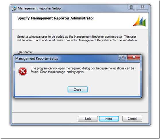

Then I got the following error – WCF HTTP Activation be enabled in the Microsoft .Net Framework features. At this point, I was ready to kick myself. I was reading the installation guide again and again, but these 3 items were in the system requirements document.
After that I got this error – and understood that this was not going to happen on my PC. Shifting over to a VPC.

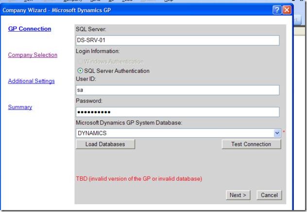

Another error that my colleague Tina mailed me about was the “Invalid version of GP or invalid database”'
Management Reporter only works with GP 2010, it doesn’t work with GP 10.
