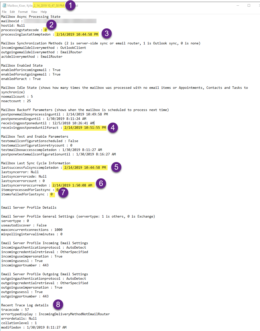

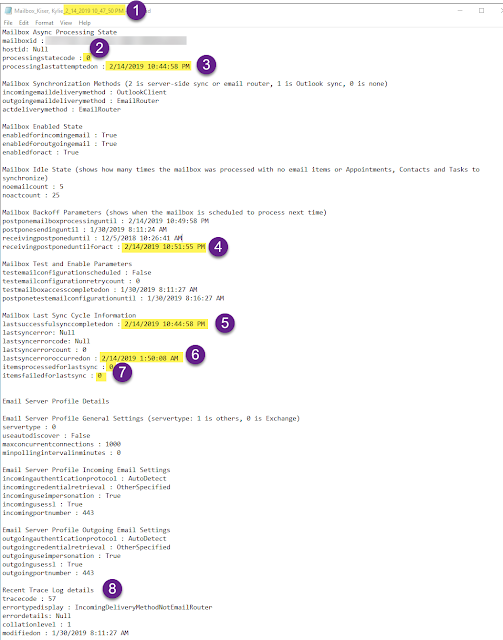

When reviewing a specific Mailbox inside of Dynamics 365 there is a button on the ribbon to "Download Mailbox Details". This gives you a lovely file of information you do not know how to read. So here is what I learned about this file through the process.
  1. Current Date and Time in UTC - All the times in the file are in UTC. If you don't feel like doing the conversion (me!) then you can just check the file name to compare current time to the time in the file.
  2. Processing status - 1 means currently processing. 2 means not processing right now.
  3. Time of last Processing attempt - also stored in CRM "Date Processing Last Attempted"
  4. Next Processing for ACT - ACT = Appointments/Contacts/Tasks. This is the next time a sync will be attempted. This should be just a few minutes after the last attempted processing and should be in the future (i.e. if it's a past time then for some reason it didn't process when it was supposed to).
  5. Last Successful Sync - Time of last successful, completed sync
  6. Last Error on Sync - The last time a sync encountered an error
  7. Processing details - number of items successfully processed on last sync and number of items that failed during the last sync
  8. Error details - full details of all recent errors. These are also visible from the Alerts area of the mailbox. This will show you the full error details if it was not all visible in the interface.
