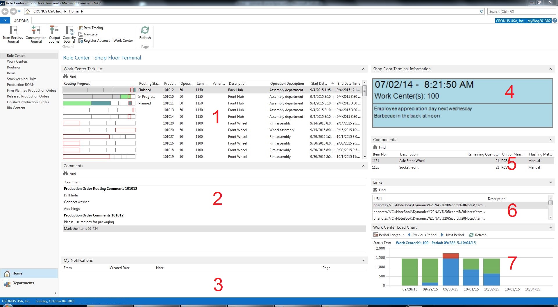

The components in the Shop Floor Terminal role center are;
1. Work Center Task List
2. Comments
3. My Notifications
4. Shop Floor Terminal Information
5. Components
6. Links
7. Work Center Load Chart
Shop-Floor-Terminal-Role-Center-Dynamics-NAV
The work center task list is the main part where the operator can see the tasks that are supposed to be run on the work center(s). This list also has some interactions build in; depending on what task that is selected the Comments, Components and Links are displayed related the to the operation. This way you can be completely paperless and the operator can see the information needed just by selecting the task in the task list.

2. Comments
The comments part displays the comments associated with the production order. The comments displayed are the comments on the production order routing line highlighted in the work center task list and the comments on the header of the production order.

3. My Notifications

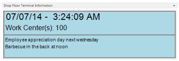

This shows the current date and time (yes it updates itself each second  ), as well as the work centers that are part of the terminal (in case there are multiple different work centers defined to be displayed at the same terminal).
The lower part can contain a message to be displayed to the operator (the message is defined against the user id in the shop floor terminal setup table).

5. Components
Shows the components related to the operation selected in the task list (using the routing link code as a filter). Nothing strange.

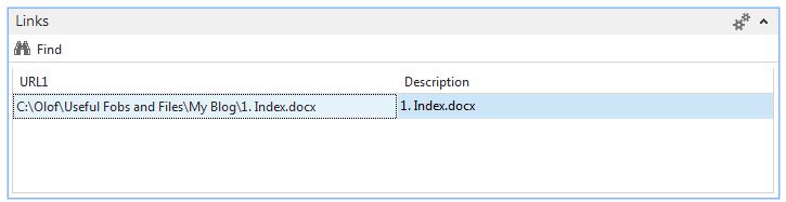

6. Links
The links displayed are the links related to the item being produced. This is typically where you link to drawings and work instructions. Displaying the links like this give the operator an easy access to those documents.
The work center load chart is displaying available vs. allocated capacity. It is intended to provide the operator an overview of how much work there is planned. Green shows available capacity, blue shows allocated time and red shows what have been over scheduled.

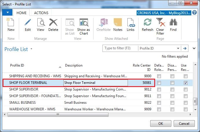

Next you create a role center for the shop floor terminal users. In the below screen shot I called it ‘SHOP FLOOR TERMINAL’. The role center is setup to use page 50081 (as downloaded).
