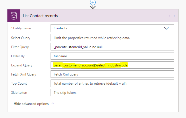

1. Add List records action from Common Data Service (current environment) connector
First of all, you will need to add a "List records" action for Contact with the Expand Query to retrieve the Industry (industrycode) of the Company Name (parentcustomerid)

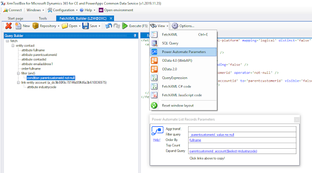

2. Get Expand Query parameter for List records using FetchXML Builder
If you're not familiar with Expand Query of the CDS Web API, use the FetchXML Builder tool (FXB) from XrmToolBox by Jonas Rapp. (don't be fooled by its name. It can be used for OData and WebAPI queries as well). For more details on how to use the tool to get Power Automate Parameters, read step by step guide in this blog post by Sara.
As in the screenshot below, build the FetchXML query and click on View > Power Automate Parameters which will show the pop-up with the values to fill up in the "List records" action of the flow.
3. Add Expand Query from FetchXML Builder to the List records action
Copy the Expand Query from the FXB to the Expand Query of the List Contact records action.

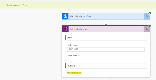

4. Get sample data for Parse JSON action
Before we Parse JSON for the output of the List records action, let's Test run to get the sample data in order to generate the schema. When the Test flow runs successfully, click on the "Click to download" link of the List records action OUTPUTS to see the output JSON.

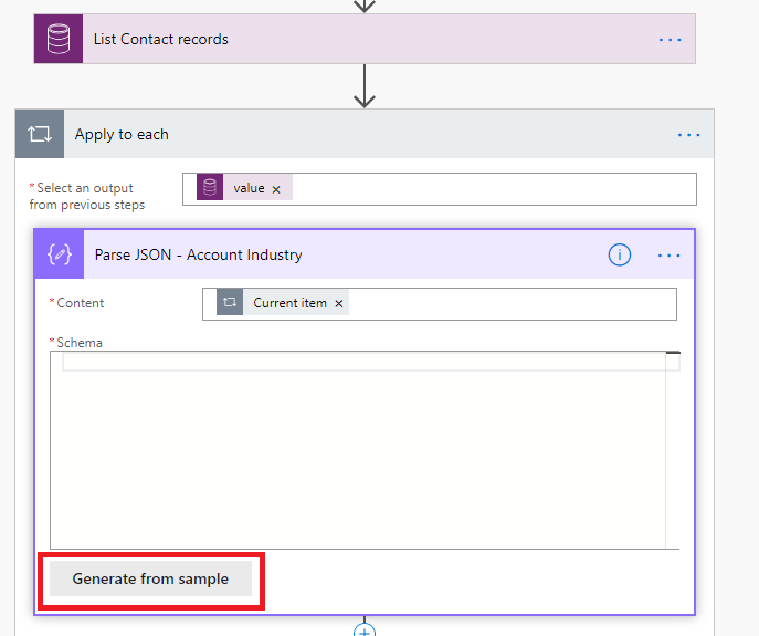

5. Generate schema in Parse JSON action using sample JSON value
If you want to know more details about parsing JSON, you can read it here but you can also follow the next step below just to achieve this.
Within "Apply to each" control, add a Parse JSON action and click on the Generate from sample button

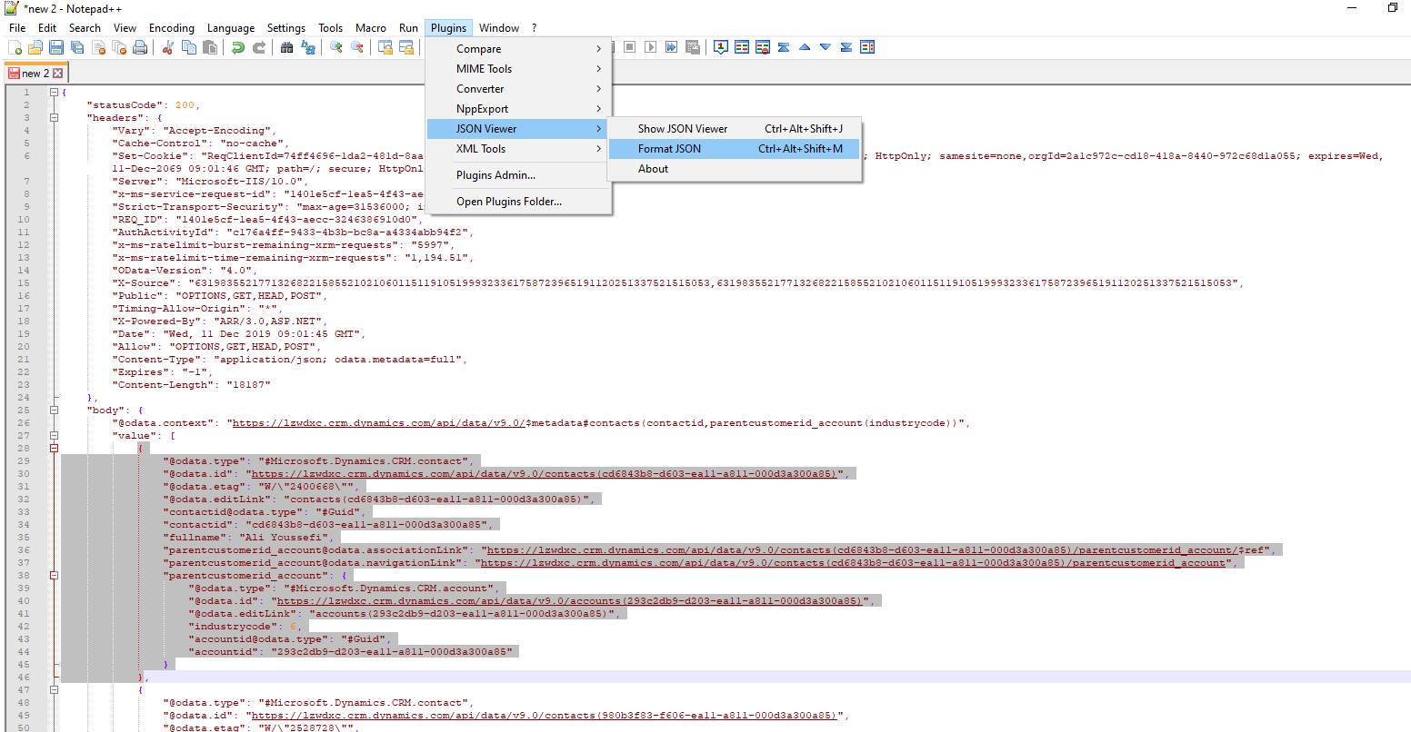

6. Extract the sample value JSON from the List records action OUTPUT
Format the sample JSON output from the previous step using any of your faviourite tool for better readability. In this case, I use Format JSON command from JSON Viewer Notepad++ plugin.
From the formatted JSON, select one record block within "body" > "value" as shown in the screenshot below.

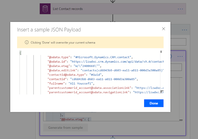

7. Insert a sample JSON Payload
Insert the sample JSON payload from the step above into the pop-up of the Parse JSON action and click Done.
