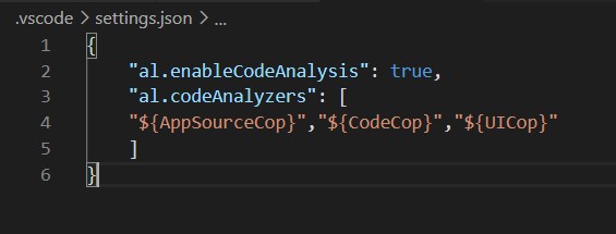

If you are developing an app for AppSource (ISV, Add-on Apps) then you need to enable below Code Analyzers
AppSourceCop
CodeCop
UICop

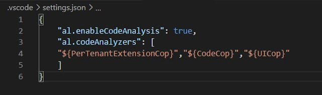

If you are developing a customization for a specific customer then you need to enable below code analyzers
PerTenantExtensionCop
CodeCop
UICop
Do not forget to set "al.enableCodeAnalysis"true
