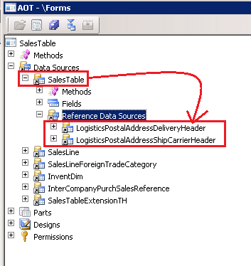

1. The date effective data sources are added under the sales table datasoure node as reference data sources.

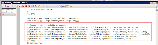

2. The below piece of code on form init() method to check the validity:
If you doing some development task and plan to add date effective tables as reference data source, then make sure to model it the same way. Not doing so will cause an issue that the expired records will display a "Unknown" value in the reference data source record. A similar problem has been reported on Microsoft dynamics AX community forum. Detail can be found at this link. The below image reference is taken from the link:

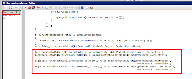

3. The below piece of code is added on sales table datasource >> init() method, to set the valid time state range criterions:
