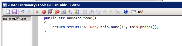

In context of AX, extension methods have similar characterstics. Lets take a very common exmaple. If we have to create a new method on a customer table which returns the customer name and telephone number as one concatened string. Normally we would create a new method on a standard CustTable object which will return the required result somehting like below.
Now there is nothing wrong in such method till AX2012 version but in the new AX (D3FO) doing this will fall under the umbrella of customising the standard AX object. This is not recommended in D3FO as it comes with lot more pains on managing such developments when installing new updates and upgrading the system.
