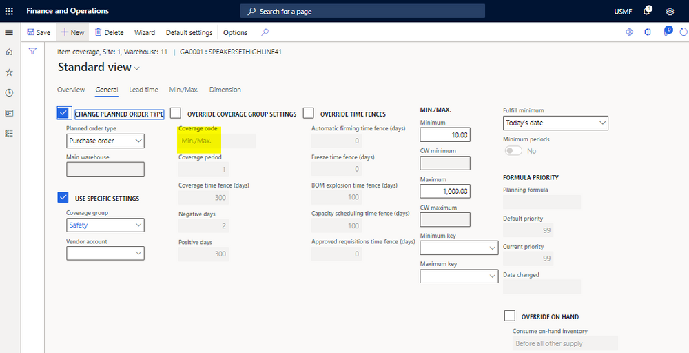

Master planning is driven of coverage groups setups as well as item coverage setups at the released product (REVIEW COVERAGE GROUP FOR ITEM GA0001)
Coverage code specification: (defaulted in from the coverage group assigned)
Coverage group logic based on:
•Manual - The lot-sizing method where the system does not suggest purchased, transfer, or production orders for the item. The planner for the item will be in charge of creating the required orders for the replenishment of the item manually.
•Per requirement - The lot-sizing method in which the system creates a planned purchase, transfer, or production order per requirement for the item. This is generally used for expensive items with intermittent demand. Means a SO is created, and then a planned order herefore is created.
•Per period - The lot-sizing method that combines all the demand for a period into one order for the item.
•Min/Max - The lot-sizing method that contains the replenishment of inventory up to a certain level when the predicted on-hand is below a threshold up to the max.
