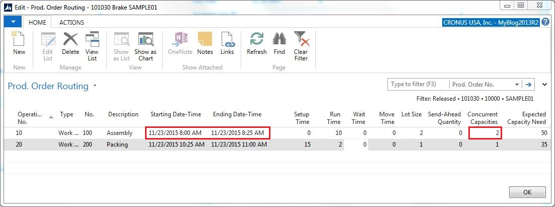

Run Time
The run time should reflect the time it takes to produce a certain quantity specified in the lot size field (also see previous post Production Lot Sizes), it is entered in the unit of measure specified in the routing. The run time is multiplied with the quantity of the production order, if for example the production orders is for 10 units and the run time is 10 minutes per 2 units then the allocated time (expected capacity need) on the work center is 50 minutes (10 / 2 * 10).
Run-Time-Routing-Dynamics-NAV
If the concurrent capacity is set to something else than 1 (representing multiple machines or employees doing the same work concurrently as described earlier), then the start and end time is adjusted accordingly. Concurrently capacity of 2 will finish the operation in half the time, but with the same amount of allocated time.
Run-Time-Routing-Concurrent-Capacity-Dynamics-NAV

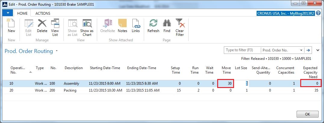

Move Time
The move time is the time it takes to move the material to the next operation; it is specified in the move time unit of measure on the routing. The move time sits between the two operations and is assigned to the preceding operation.
Like the wait time, the move time does not allocate any time on the work center. But it is inside the calendar of a work center (the product will not move itself during the night  ).
Move-Time-Routing-Dynamics-NAV
