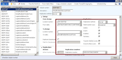

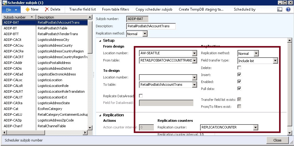

5. Now go to Retail ->Setup ->Retail Scheduler ->Scheduler subjob
Create a new subjob :
And set the important fields as below :
