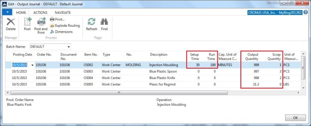

Then we post the output for the different products. In this case we use the output journal where we enter the output quantities, scrap quantities and the times. Note that we now can enter the total time against one of the production order lines and Dynamics NAV will later allocate the costs according to the percentages.

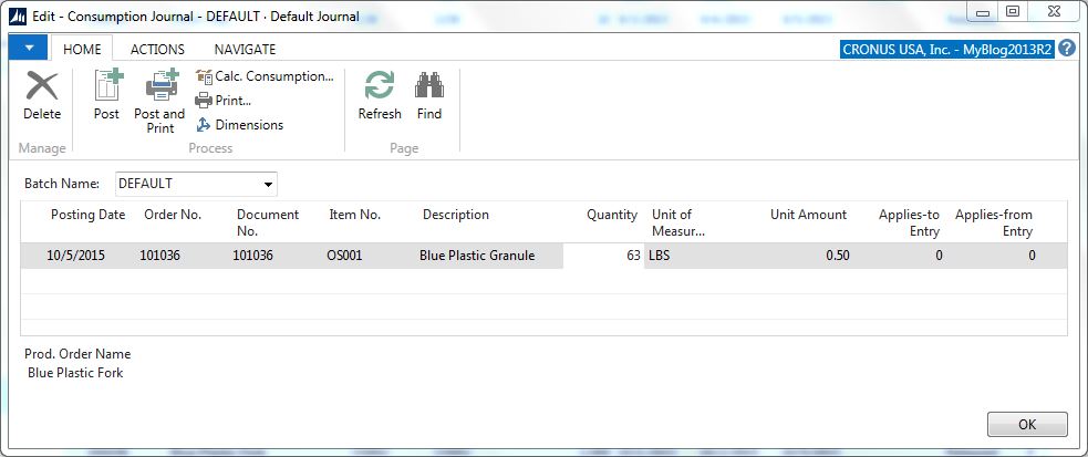

Next we post the consumption. Same here; we can enter the total quantity consumed against the first line and Dynamics NAV will later allocate the costs according to the percentages.
Consumption-Journal-Multiple-Outputs-with-Cost-Allocation-Dynamics-NAV
