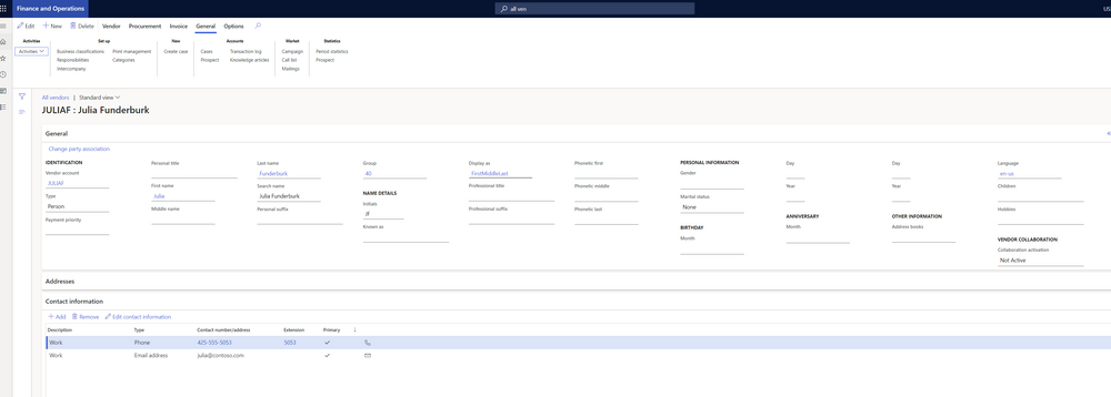

  • Set up Shipowner as vendor records. (party that facilitates the shipment and gets paid a flus through charge by the broker means us)

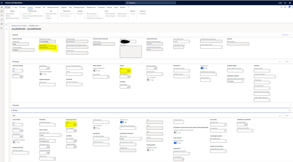

  • Set up released product for commodities that will be shipped with 0 purchase/sales price (we later create payables/receivables primarily via charges/cost types as we do not physically purchase/stock the product to be shipped anyways)

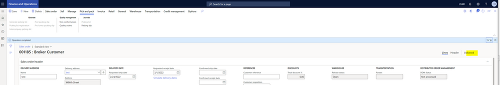

4. SO confirmation:
As soon as all data elements are entered, the Sales order is to be confirmed.
See below the SO confirmation process.
The operation processed successfully.
5. SO packing slip posting (batch or manual):
As a next step we post the packing slip that decrements the inventory. As we allowed negative inventory, we are fine to do so here. The packing slip will be posted manually. (but this can also be set up as batch job if needed).
See below the SO packing slip posting process.
After processing the SO changes its status to delivered.

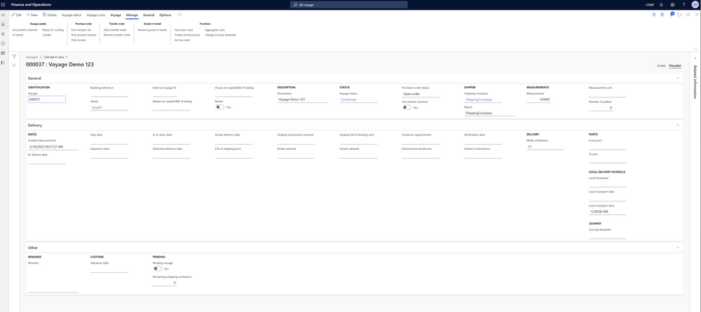

10. Voyage processing (up to “ready for costing” status):
As a next step, we can maintain information such as Bill of lading or Master Bill of lading, Measurements and Measurement units (e.g. weight), Departure time, Estimated delivery date, Actual delivery date, ETA at shipping port, Date when original documents are received, Broker advised date field, Goods released date, Verification date, etc. on the voyage itself and track the voyage with dates for each of the logistical steps (legs) it goes through. In our case it is simply point to point to keep things simple. Additionally, there is a remarks field what can be used free text. (if required) A user can use document handling to attach emails or documents to the voyage if needed.
We can advance the voyage through multiple stages depending on what documents/information are provided and where the voyage is from a logistics standpoint (e.g. “documents received, in transit, ready for costing)
We process the voyage through the natural cycle - means up to "ready for costing".

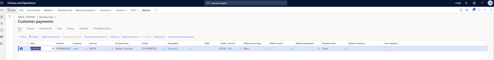

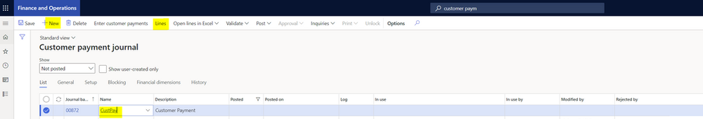

12. Customer Payment journal:
As soon as the payment is received, a customer payment journal is leveraged to record the payment. This credit the invoice balance and debits the bank account.
After creating the journal we add lines for the above invoice, settle the transaction and post.
