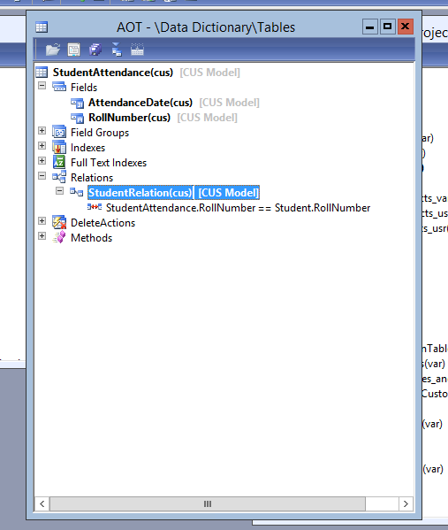

Then Create relation as per your requirement. I am using Normal relations.
Student
Student Attendance

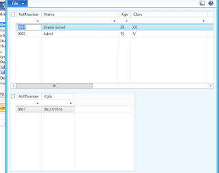

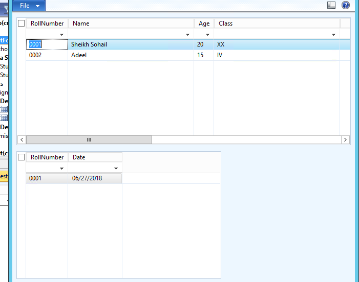

Now create New Form and Add two Gird [StudentGrid] & [StudentAttendanceGird]
Lets begin

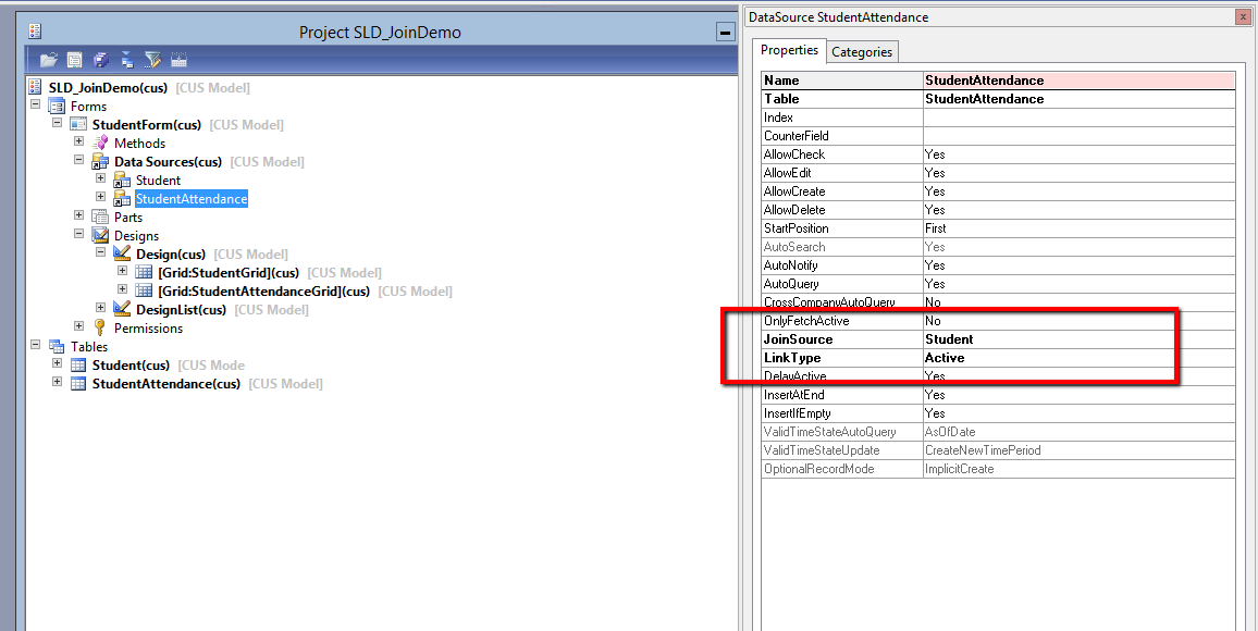

Passive Join Type
Passive form data source link type won't update the child data source automatically. For example if we select the parent table order then order details child data source won't update. If we need to update the child data source we need to call the child data source execute query method by program (code).
Active Join Type
Active link type update the child data sources without any delay when you select the parent table record. When you deal with more records it will be affect application performance.

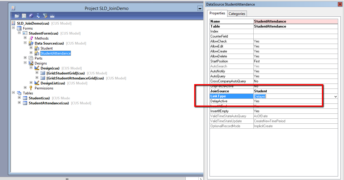

Delay Join Type
Delay form data source link type is also same as active method the different is delay method won't update immediately when you select the parent record. It will update the child data source when you select the parent table, Ax use pause statement before update the child data source.
