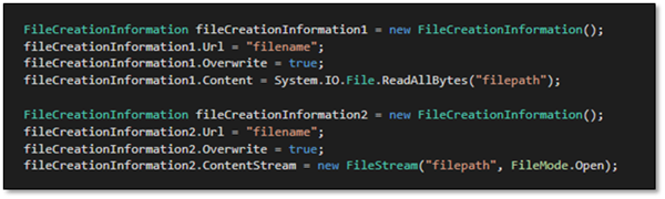

Let’s take a look at the FileCreationInformation object – we can use this with an API call to specify a file to upload, and how to upload it. You can also set another flag to say whether you want the file to overwrite existing copies or not, which is something you might want to be careful setting. The properties we’re most interested in are the Content and ContentStream properties, as demonstrated here:
If you use the Content property to upload your file, it needs to be smaller than 2Mb in size or else SharePoint will refuse to let you upload it. That’s because you have to attach the entire contents of the file to the FileCreationInformation object as a byte array if you’re using that particular property.
On the other hand, you can also use the ContentStream property which accepts a FileStream instead of a pure array of bytes. Working with FileStreams can have a couple of advantages over byte arrays – in this scenario it allows the SharePoint API to stream the contents of the file to the server in a more manageable and reliable manner. With larger files, SharePoint is much more comfortable receiving the data in stream format and it’ll happily accept more hefty files (the upper limit is 50Mb by default but can be adjusted in the configuration).

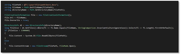

Now that we know our limitations, let’s get a code snippet to conditionally upload a file using either a byte array or a FileStream, depending on the size of the file:
This code snippet will get your file into memory in whichever way is most appropriate. You might notice that I’m doing an “if (filesize > 1300000)” check, which is somewhat less than the 2Mb limit I mentioned earlier. This is because of the overhead that gets added to the message from its headers and extra information sent to SharePoint. So in reality you can try to upload a file that’s 2Mb in size using a byte array, but SharePoint will check the actual size of the whole message and probably ruin your plans. During my tests I found that roughly 1.3Mb was a safe value to use for this check, but you can feel free to fiddle around with higher values to see if you can squeeze some extra efficiency out of your uploads.
