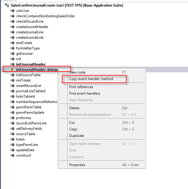

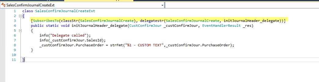

 Now we create the event handler method and this is where MS has done really nice stuff in moving the AX development environment to Visual Studio. Right click on the delegate method and copy the handler method definition.

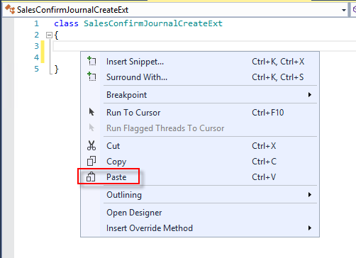

Create a new class which will be used to subscribe to the delegate. So we create a new class, let call is salesConfirmJournalExt and paste the copied clipboard text

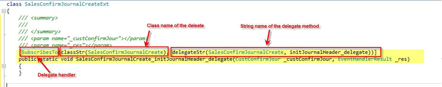

The delegate handler definition is automatically added with the below information:

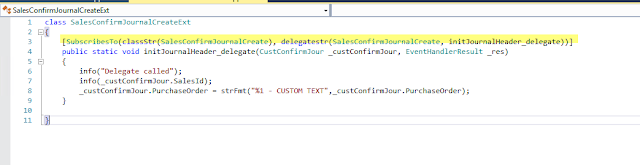

Now we can add our custom code in this method. I just changed the purchase order field value and added some Infolog. Note that I am actually not returning anything in this method and not using the eventHandlerResult object really.

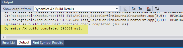

 So we are done. The see it wokring let's build the solution and confirm a sales order.

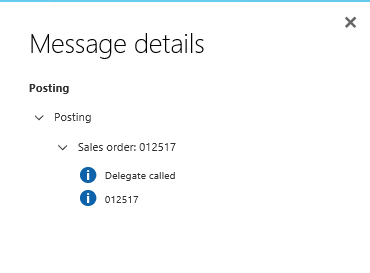

During the process the  Infolog messages we added in the delegate handler method are shown

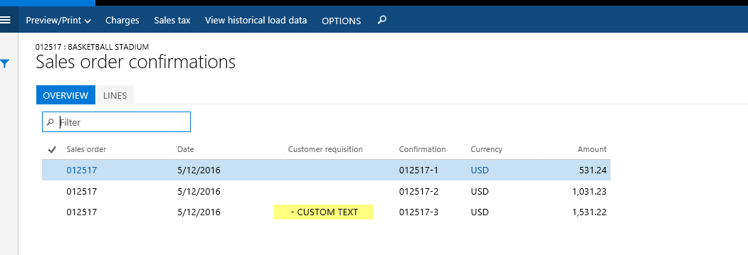

The confirmation journal has the custom text appended to it in the field we used in our new class method.
