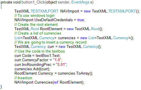

Now we are going to test it using Microsoft Visual Studio. Create a new Windows Form Application. Add a Web Reference to http://localhost:7047/DynamicsNAV/WS/TESTCOMPANY/Codeunit/TestXMLPort. Add a textbox and a button to the form and double-click the button. Add the following code to the button's on-click event.
And finally, compile and test the application.
