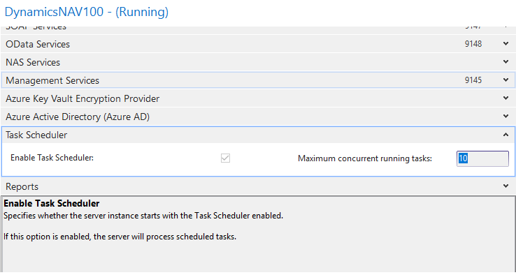

By default, Task Scheduler functionality is enabled, but it is possible to disable it in the Dynamics NAV 2017 Administration Tool. You can also set the maximum number of tasks that could run concurrent on the server.
Figure 1. Properties “Enable Task Scheduler” and “Maximum concurrent running tasks” in Dynamics NAV 2017 Administration Tool

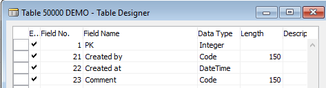

I have created the following custom “DEMO” Table. This example will create a task that would enter a record to this “DEMO” Table.
Figure 2. New “Demo” Table

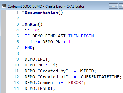

I have also created another “DEMO - Create Error” Codeunit (ID 50005), which would execute in case the task would fail.
Figure 4. New “DEMO - Create ErrorCodeunit

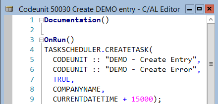

The next step was to call the TASKSCHEDULER.CREATETASK function with following parameters:
Figure 5. TASKSCHEDULER.CREATETASK function
Once this codeunit is executed, a new record is created in “Scheduled Tasks” Table (in same Company, because Company = COMPANYNAME) with ID = {cbdc7bba-fb86-47ba-938e-0776221cb750}

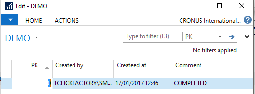

After 15 seconds (because NotBefore = CURRENTDATETIME + 15000) codeunit ID 50000 (because CodeunitId  = CODEUNIT :: “DEMO - Create Entry”) will be executed, which would create a record in Demo table
Figure 7. Record created in “Demo” Table

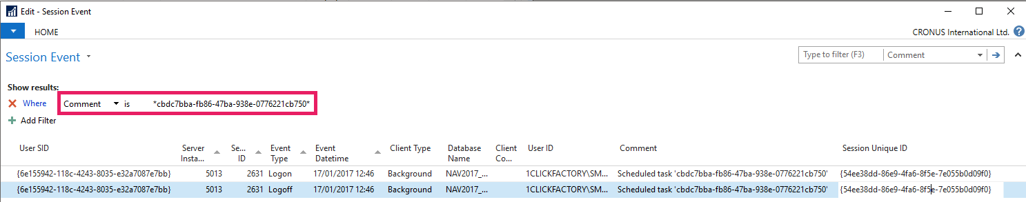

One more important thing to add is that in the  “Session Event” system table (ID 2000000111) you can find all active background sessions started for each running task.
Figure 8. Records created in “Session Event” Table

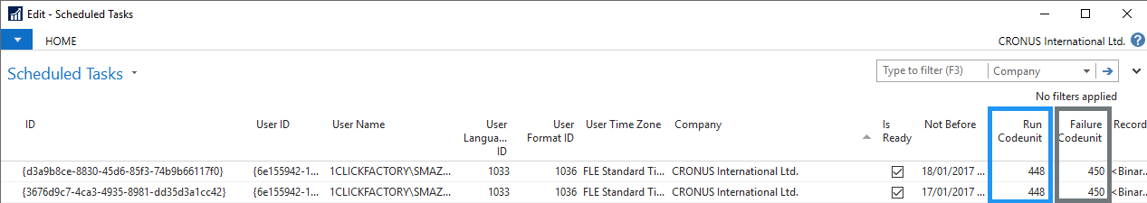

There are 2 new fields in the “Job Queue Entry” Table: “System Task ID” and “Scheduled”. Once the Status of Job Queue Entry is set to “Ready”, the TASKSCHEDULER.CREATETASK function is called in “Job Queue – Enqueue” Codeunit (ID 453), which would create record in “Scheduled Tasks” table and fill System Task ID, (i.e.“Job Queue Entry “.”System Task ID”  = “Scheduled Tasks”.ID).
Codeunit “Job Queue Dispatcher” (ID 448) would be handling the task -  executing the object that is specified in “Job Queue Entry” Card as “Object ID to Run” at needed time.
Once it is done – the old record is deleted from “Scheduled Tasks” Table and the new one is created with updated “Not Before” field value, based on recurrence rules in “Job Queue Entry”Failures would be handled in “Job Queue Error Handler” Codeunit (ID 450).
Figure 9. Records created in “Scheduled Tasks” Table regarding Job Queue entries
