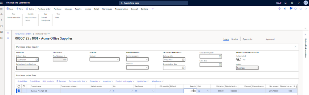

Now, we create, confirm and receive a purchase order from scratch for item 1000 and a quantity of 300. The 300 that we have now onhand is still below the 400 specified as minimum for item 1000. Based on the above and since we didn't firm the planned orders yet, we would expect that the requirement quantity on the planned order will be updated to 780-300=480.
Purchase order created for item 1000 and quantity of 300:
Purchase order confirmed and received:
