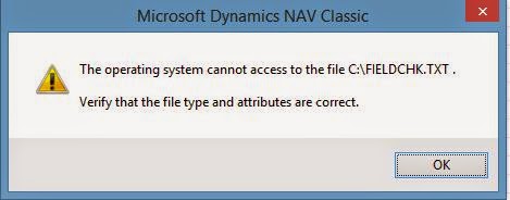

3. Run Codeunit 104010, you might end up with below error. If Not GO TO STEP 5.
4. Design Codeunit 104010 and change the Location to Non Root Drive as shown Below.
Save the Codeunit.

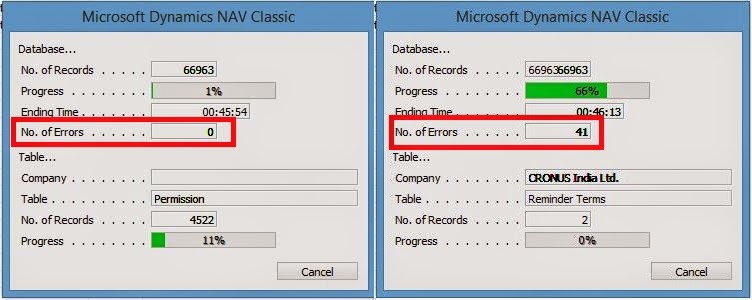

7. Run the Codeunit 104015. It will check for all data in the database which is not acceptable by SQL Server Database.
** Execution Time Depends on the Data in Database. Please be patient.
8. Once the Job is complete System will popup a total count of Incorrect Values that are not acceptable by SQL Server.

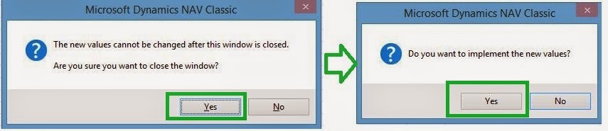

10. Once Update Done Click ESC or Close the Form. It will ask for Confirmation.
 -- Make sure you say YES on Both Otherwise you need to repeat activities after Step 5 again.
