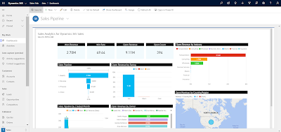

PBI dashboard with D365

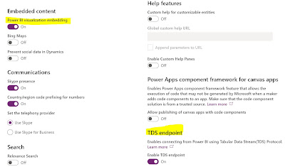

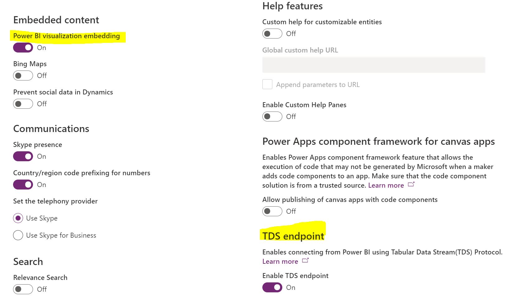

A - Setup needed - For this blog series we will need the capability of adding Power BI visuals into D365 (dashboards and visuals) as well as enable the TDS (Tabular Data Stream) endpoint. This is done by going to admin.powerplatform.microsoft.com and select your D365 environment (tip - its not the default one). Environment > Settings > Product > Features and enable the 2 highlighted below

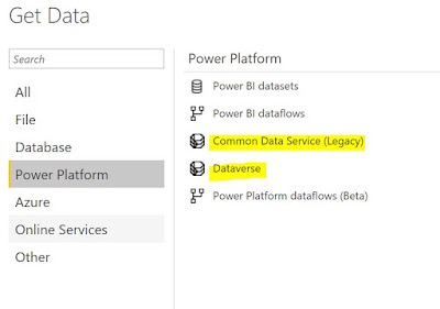

1. Once you have the above and downloaded the Power BI desktop latest version (note the version changes ever month) you can click on > Get Data.
This will open up a myriad of options (enough to baffle you and maybe you feel like in a candy store), but lets focus on the Power Platform for now. Select Power Platform and you have 2 main options (dataflows is not the topic of my current blog, maybe in the future)
Connect options
Dataverse connector is the latest one offered (I am going to use it for this blog) The limitation here is that the size of the dataset is limited to 80MB. If your needs are more than 80 MB (which is quite obvious when using large datasets) use the CDS legacy connector. I am hoping that the Dataverse connector allows larger datasets in the near future.

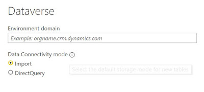

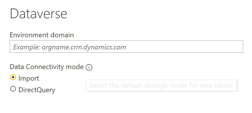

Once you click on connect with Dataverse. it will ask you if you want to import data or do a Direct Query. For this blog I am going to import the data into Power BI. At this time it is important to note that there is an important security difference between importing data into Power BI and using Data query. I will revisit this in my next blog.
Connectivity mode

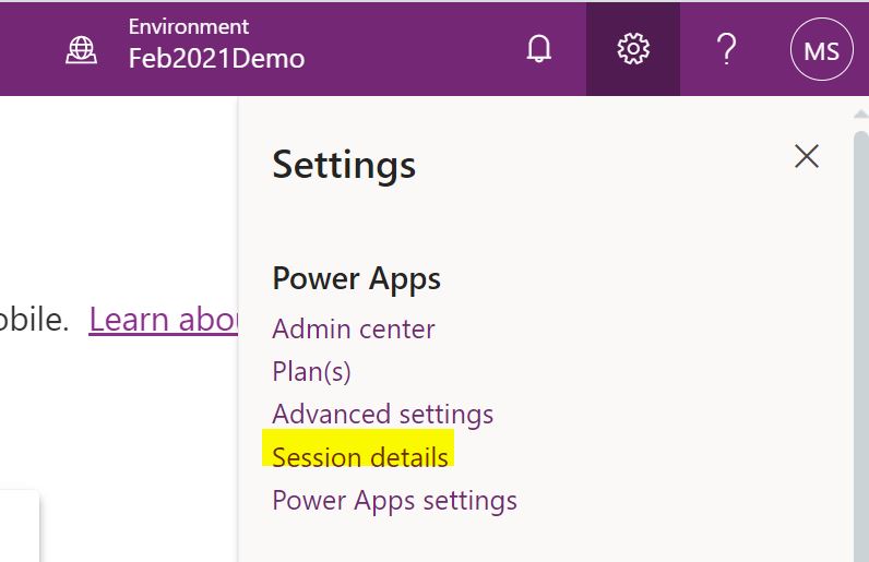

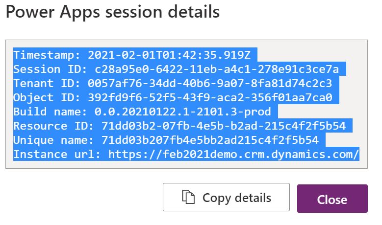

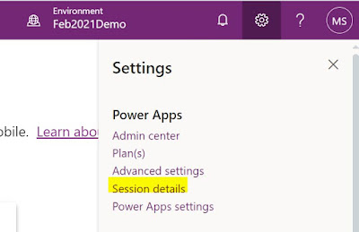

Another thing that you will need to enter is the environment domain. It used to be simply coping your D365 domain url but Microsoft has made it a little complex. Now you are supposed to enter the url without https:// and remove the / in the end (had to do this twice just to get it right) If you don't know what is your environment domain url Go to Make.powerapps.com select your environment (not default) and click on Settings > Session details.
Instance url

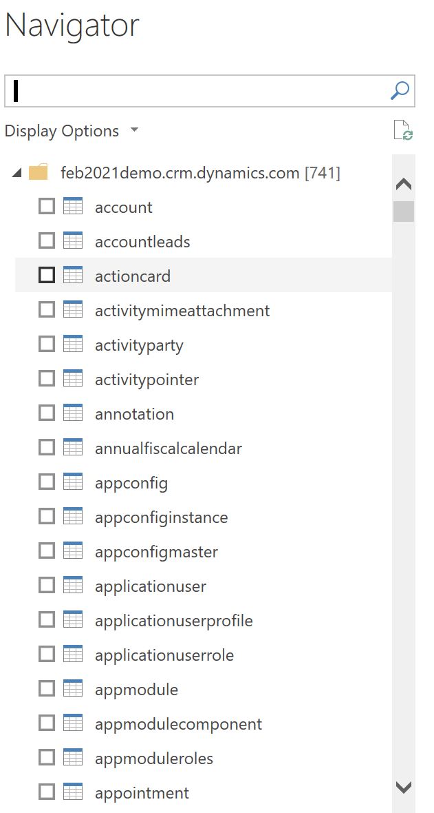

Once you have the details and click 'ok' you may be prompted to sign in (if you are not already signed in) and then shown the Navigator window to chose from the tables to import into Power BI.
Select Table

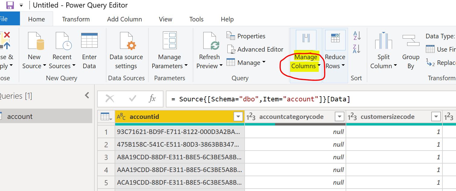

Once you select a table make sure to select 'Transform Data' which will open up the Power Query Editor
Select columns to import
Here click on Manage Columns and you will be able to select which columns you want to import. It is important to know the Dataverse data model to be able to understand what columns you will need to create your visualizations.
Once you have selected the columns click on Apply and this will start the import process. In my next blog we will look at the options for working with D365 data in Power BI.
