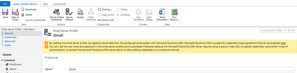

As you can see, the Email Server Profile tells us that the server requires SSL before we can specify credentials, and that we need to allow setting credentials on a nonsecure channel.

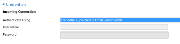

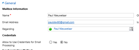

We can also see below that if we try to specify credentials on the Email Server Profile, the User Name and Password are disabled, and on the Mailbox the radio button "Allow to Use Credentials for Email Processing" is disabled.

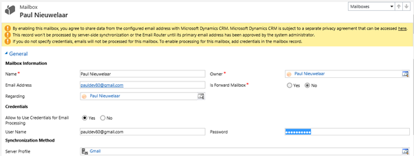

Once that's done, perform an IISRESET for the changes to take effect. Then, refresh your Mailbox or Email Server Profile and you should be able to specify credentials.
