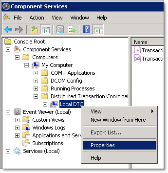

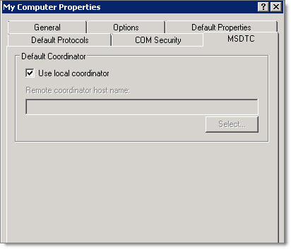

But then I thought I should just try and check the basics to see if there was anything else I can identify that might help to troubleshoot the issue.  So I start with the basics:  Check the MSDTC configuration.  On the SQL Server, I open Component Services.  When I right click on My Computer and view Properties, I'm greeted with an unfamiliar version of the window--there are no MSDTC options.
I forgot that on Server 2008, the DTC configuration is located in a different place in Component Services--it's under a separate folder called "Distributed Transaction Coordinator".  Hiding in plain sight, very sneaky.
When I checked the DTC security options, all seemed well.

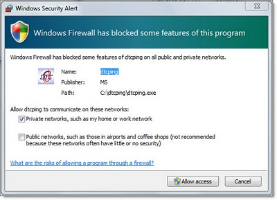

I then decided to check the SQL Server to confirm that the Windows Firewall was disabled.  Alas, the firewall was enabled.  Aha!  When I turned off the firewall, sure enough, DTC Ping operated fine in both directions between the app and SQL server.  And I also found that the option to "Notify me when Windows Firewall blocks a new program" was unchecked, which is why I didn't receive a dialog when DTCPing was blocked.  When I enabled notifications, I received this message when I launched DTCPing.
So, now the fun hunt for the Windows Firewall Rule that would enable inbound DTC traffic on the SQL Server.

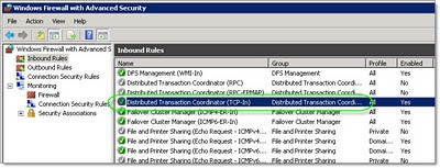

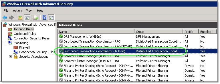

After some searching, I learned that DTC has pre-defined rules on the Windows Server 2008 firewall.  Under the Windows Firewall "Advanced Settings", if you click on Inbound Rules, there are dedicated Distributed Transaction Coordinator rules.  But there are 3 separate rules for different DTC protocols.

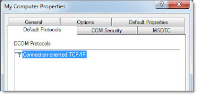

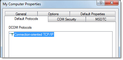

Remembering that the DTC properties window listed only TCP/IP, I guessed that the TCP firewall rule would do the trick.
Sure enough, once I enabled that inbound firewall rule, DTCPing worked fine.
