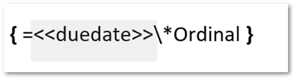

Step 1: Ctrl F9 to insert the field code.  A set of brackets will appear {}
Step 2: Inside the brackets type the equals sign '='
Step 3: Insert your field
Step 4: Type '\*Ordinal'.  Be careful to type this text after the merge field.  You may find it helpful to turn on design mode (located on the Developer tab) so it is easier to spot where to locate the text.  Here is the field displayed with Designer Mode turned on:

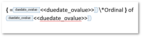

Step 5: Change the format of the field to day only (Click on the field, select field properties, type 'space' then lowercase 'd')
Step 6: Type ‘of’ and then insert the date field one more time and change its format to MMMM, yyyy.
Here is what the combination of fields looks like on your template:
And voila, the merged date:
