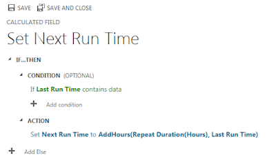

Calculated field: -

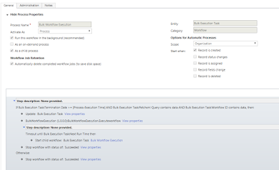

In this solution a OOB workflow is used name “Bulk Workflow Execution”.
This workflow will trigger when record is created in “Bulk Execution Task”.
In this workflow Child process needs to check.

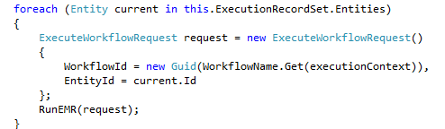

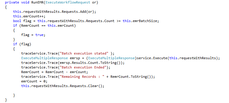

If record is created and conditions are meet a custom workflow will execute. This custom workflow responsible to run our on-demand workflow based fetch query we have specified.

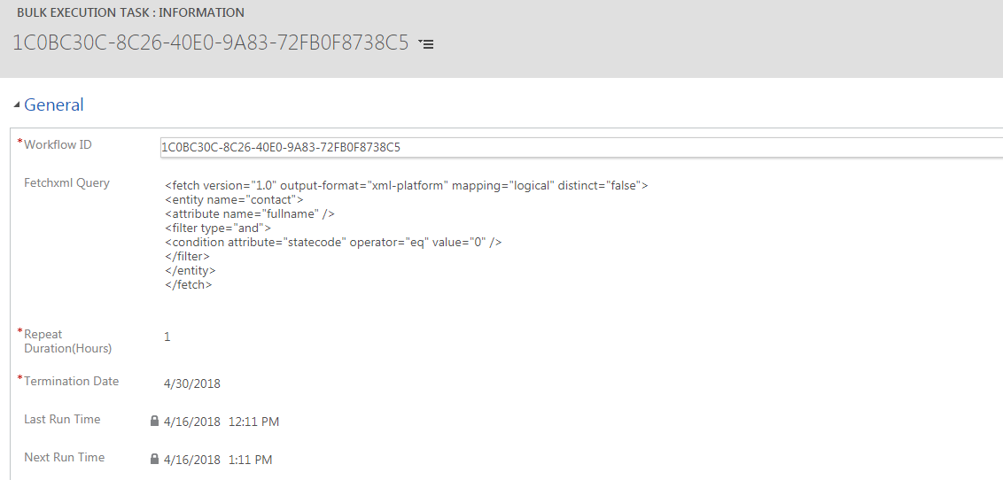

Create record in Setting->Bulk Execution Workflow->New.
Provide workflow ID.

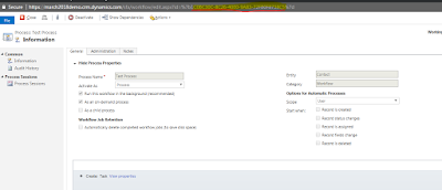

Open your workflow need to execute and copy ID from address bar. Make sure On-demand is checked for this workflow.
Provide your fetch XML query to select records. You can used “Advance Find” to get fetch query.
Provide other details.
When you save the record. Your Workflow start execution based on your information.
