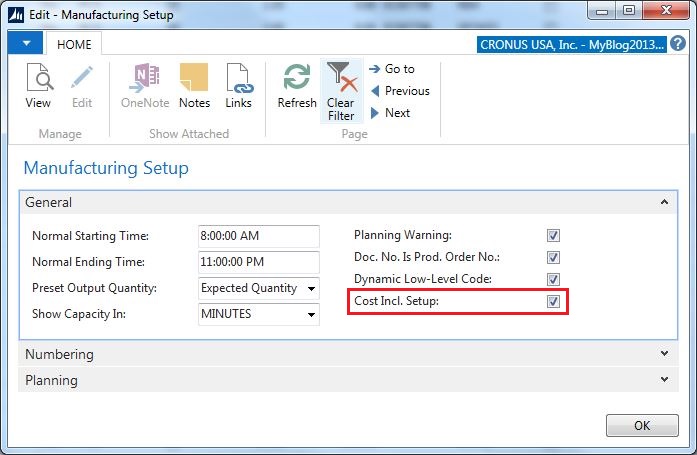

Note that the setup cost is only part of the cost roll-up if this has been activated in the manufacturing setup table through the ‘Cost Incl. Setup’ field.
CostInclSetup
