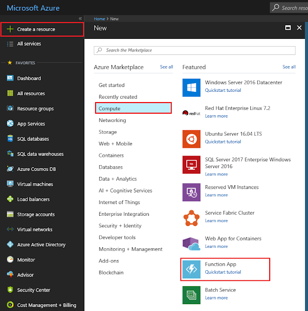

2. Create a function app
You must have a function app to host the execution of your functions. A function app lets you group functions as a logic unit for easier management, deployment, and sharing of resources.

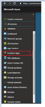

Select the New button found on the upper left-hand corner of the Azure portal, then select Compute > Function App.

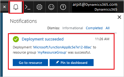

5. Select the Notification icon in the upper-right corner of the portal and watch for the Deployment succeeded message.
6. Select 'Go to resource' to view your new function app.

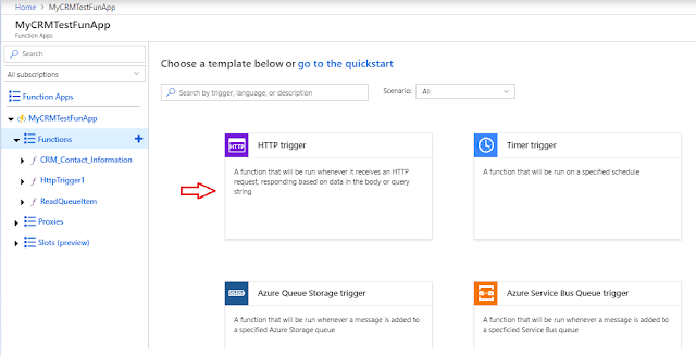

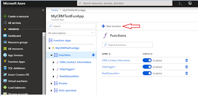

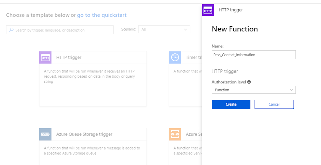

7. Click on + New function

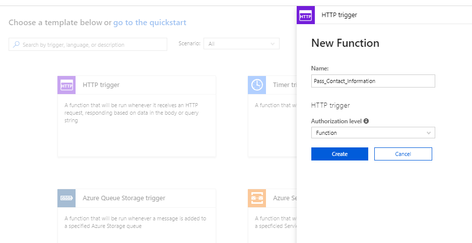

8. Create an HTTP triggered function
9. Provide function information as shown below

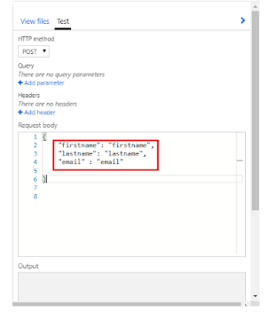

10.  Update the code and set first name, last name, email parameter
A function is created using a language-specific template for an HTTP triggered function.
Now, you can run the new function by sending an HTTP request.
Update Request body Parameter as below

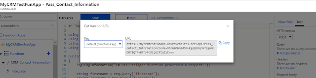

In your new function, click </> Get function URL at the top right, select default (Function key), and then click Copy. You'll get the url in below format:https://<functionApp>.azurewebsites.net/api/<function>?code=<key>
Paste the function URL into your browser's address bar. Add the query string value &firstname=<yourname>&lastname=<lastname>&email=<your email> to the end of this URL and press the Enter key on your keyboard to execute the request. You should see the response returned by the function displayed in the browser.

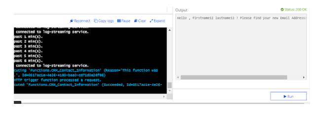

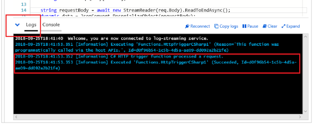

12. Trace log of Azure Function
When your function runs, trace information is written to the logs. To see the trace output from the previous execution, return to your function in the portal and click the arrow at the bottom of the screen to expand the Logs.
