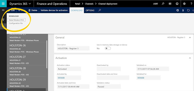

- You can download the mPOS installer and configuration file for that particular store/register/device from D365fFO instance. And it is important that the configuration file is in the same folder as the installer while you run the installer.
Go to Retail > 'Channel deployment' workspace and Click Devices tab.
Search and select 'Houston-3'.
Click on DOWNLOAD button on the Action pane. You would get two options as shown below.
- Download both and run the installer and ensure there are no errors during the installation. Like I said before - it is important that the installer and configuration file are in the same folder.

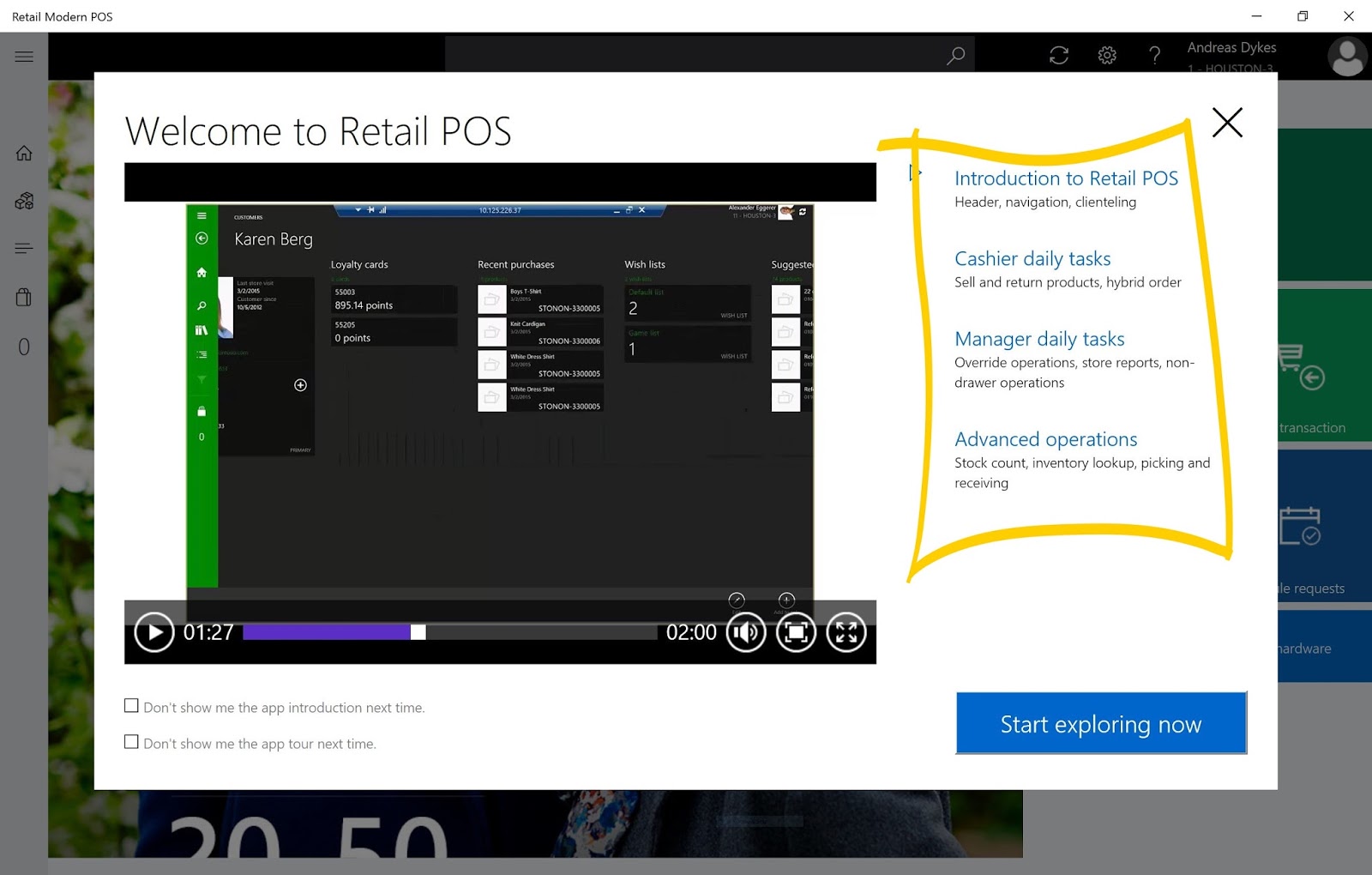

- The first time login would request for a Password change, upon completing that you might have to login again with the new password.
- Also mPOS will pop up a new user experience window/video to help you understand the tasks which can be performed in the POS.
