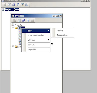

  1. Type Clt+Shift+P, you would see all the list of available Private and Shared projects.
  2. Right click and select New Project, it would create a new project by default with the name Project1.

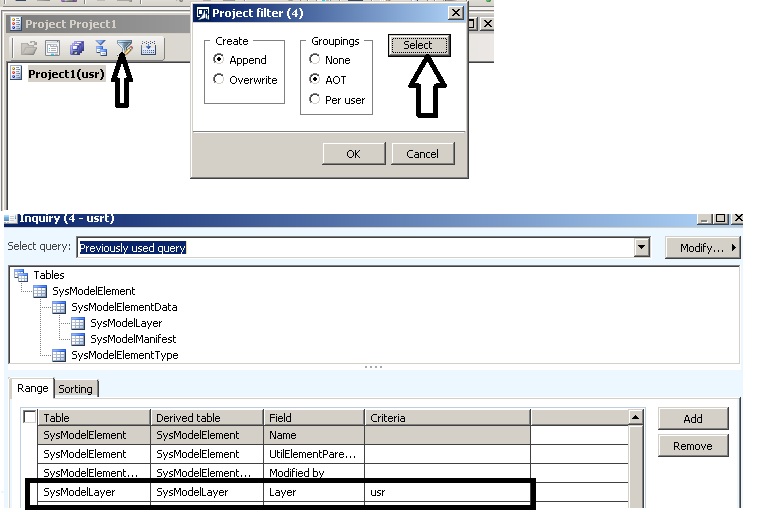

3. Next thing you need to do is open project you have created select the project filter. In dialog of project filter select the option of AOT in Groupings. Click button select for the criteria and choose the usr layer.
Here we can see the project which includes all the customization done on usr layer.
You can give any name to the project by renaming. Hope this would be useful post for you.
