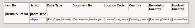

2. In Layout Group the Report with Item.
3. In above Screen you can see Sr. No. , Lets see what is the expression that i have used inside that.
Visual Studio have a simple function RowNumber To get The Row Number. Function take Group Name as Parameter as shown Below.
4. Now Let's Save and Run the Report. The Output seems as below.

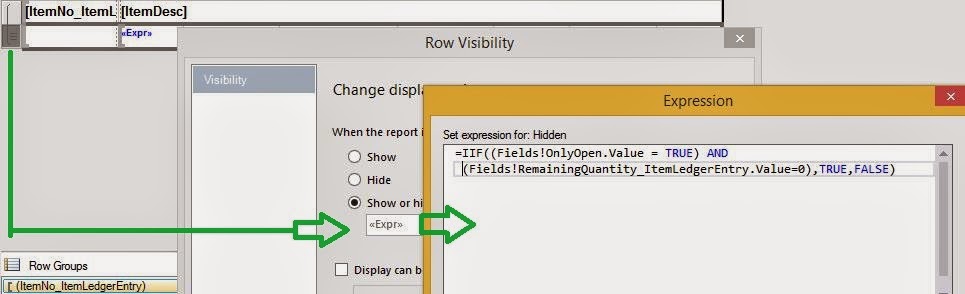

5. There are some items which don't have Remaining Quantity, as highlighted above.
6. Let's add a visibility condition for Excluding those lines having remaining quantity as ZERO.

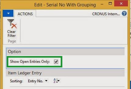

7. Let's Run The Report and select Option to Exlude Lines With Remaining Quantity as ZERO.
And the Output of Report is as below.
