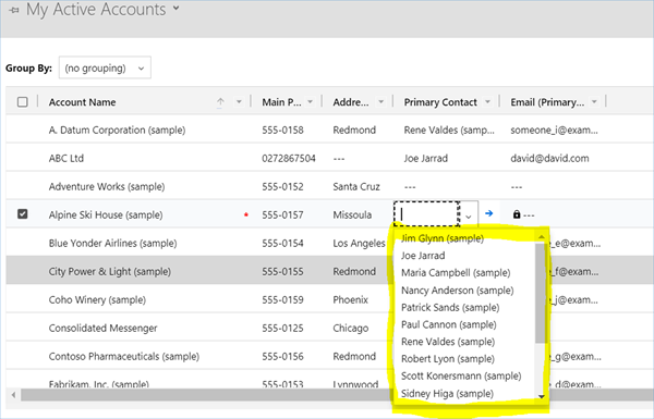

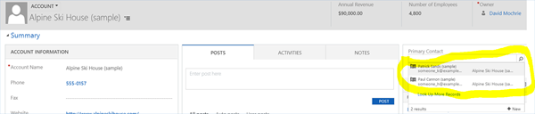

Firstly, editable grids don’t have filtered lookups applied out of the box. The lookup will show all active records for the lookup entity. So, if you enable them on Account, you’ll be able to set the Primary Contact for an Account as someone who doesn’t work for the Account via the grid, but not via the form.
Form:
Editable Grid:
This is a very inconsistent user experience and should be avoided.

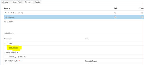

So, for each view of the Account which has the Primary Contact as a column, you should add a filtered lookup. You do this by going to the entity in Customisations, selecting the Controls tab, selecting the Editable Grid control and selecting Add Lookup.

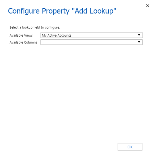

You will be presented with this dialog:

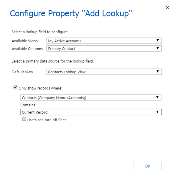

Select a view in the Available Views field. In the Available Columns, you’ll be able to select any lookup displayed in that view. In the case of My Active Accounts, the only lookup field is Primary Contact. When you select that you can then select the view to use in the editable grid’s filtered lookup and also optionally decide if you want to return only a dynamically filtered subset of Contacts, based on the record you are on.

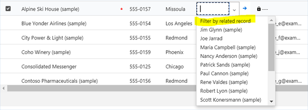

You also get the option of allowing the user to turn the filter on or off, the same as when you configure a filtered lookup on a form. If you tick that box, you get a toggle control at the top of the list of returned records on the editable grid, allowing you turn the filter on or off:
Filter off:
Filter on:
This is a better user experience than on the form filtered lookup, as there you have to go into another dialog to disable the filter.
