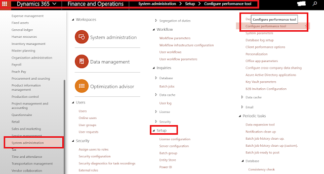

configure performance tool from system administration  under setup

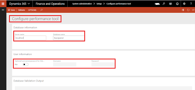

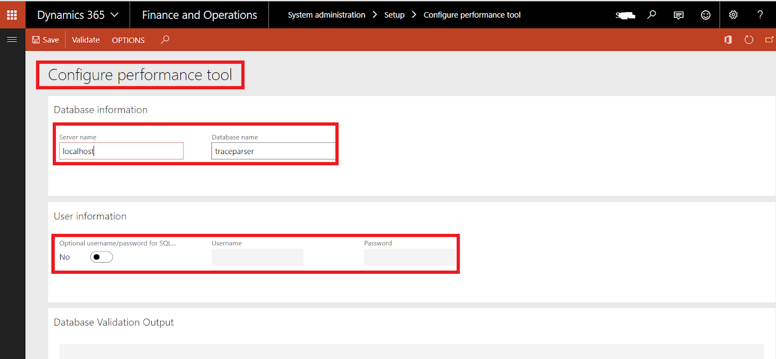

you can set the server and database name and optionally enter user credentials
