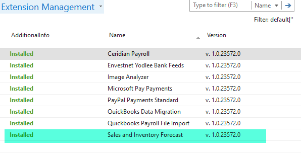

I have check the Table 27 in both databases and they have the same schema, but I still get the same error. I have compiled the objects, and restarted the NAV Service just to confirm the schema is in sync but that did not resolve the issue.
The issue was I have a extension (“Sales and Inventory Forecast”) installed in Test Database but not in the other database, so I have uninstalled the extension from the Test database and re-exported the data. This time the import ran without any error.
So, when you use Export/Import Data option, make sure you check the same extensions are installed in both the databases.
