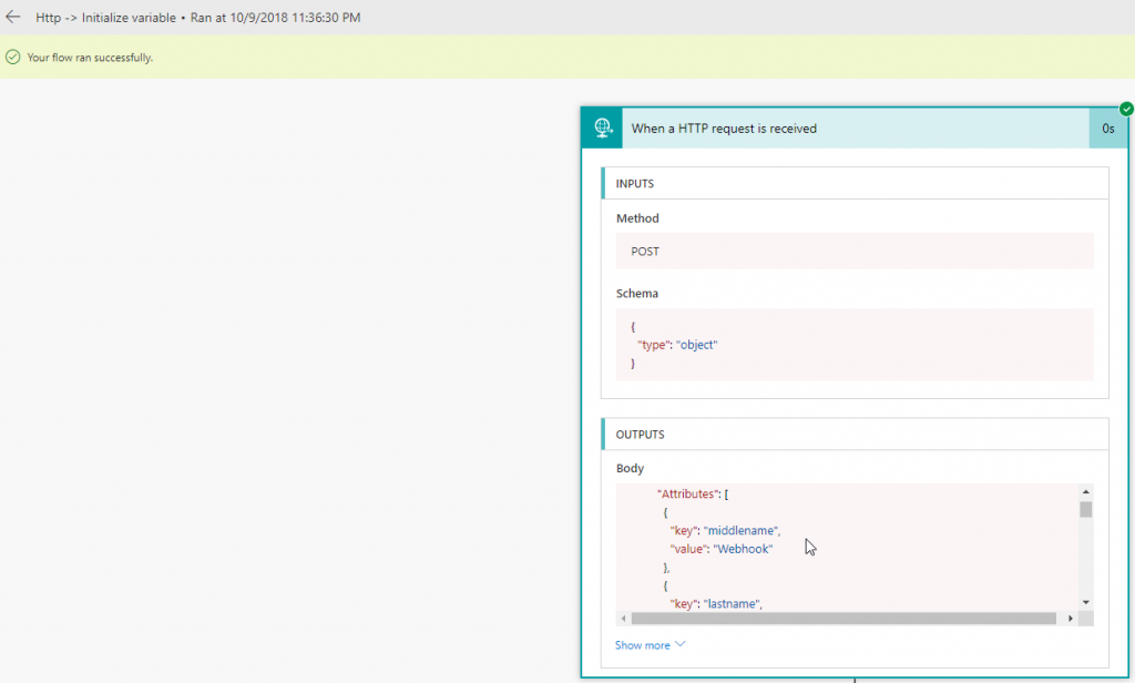

First I build a flow with the following trigger: When a HTTP request is received.
When the flow is saved, the HTTP POST URL is generated by flow and can be copied.

When I update the middle name of a Contact record in Dynamics CE and save it,
the flow gets triggered. Yes, it works! The JSON object contains the info of the update Contact record.
So I’ve shown that there’s the third way to trigger flow from Dynamics 365 CE, with the possibility of filtering on attribute(s).
