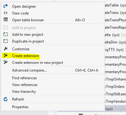

On AOT it is possible to create extensions for nearly all the object types. On most of them, you can add new nodes to the object (like new fields to a table) or modify some of the existing properties of the object (on every AX update new possibilities are emerging). To be able to do that, you first need to reference the package you want to extend in your model definition the right click the object you want to extend and select “Create extension”.

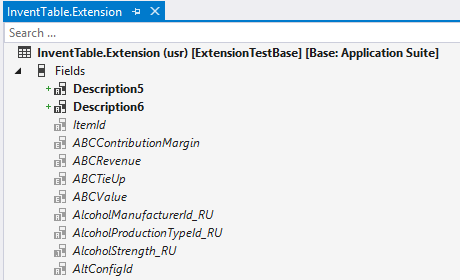

Here I have extended the Invent table and added some new fields :

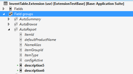

And added new fields to existing AutoReport field group :

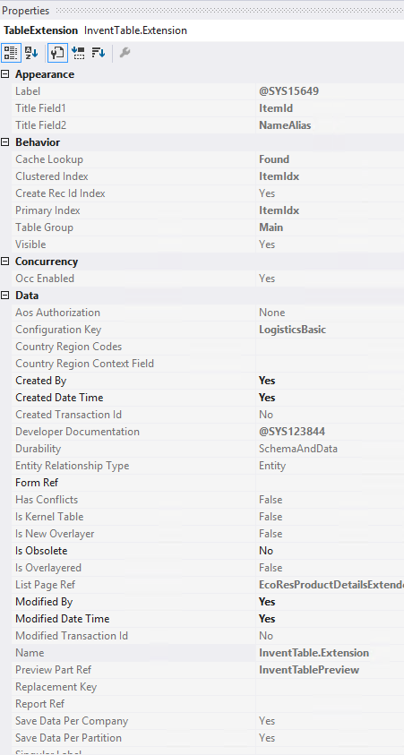

You can also change some of the properties of table fields and table itself, those are the not grayed out ones when you select the node and check its properties on the designer :

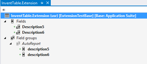

If you type “e:” on your designers search pane, you can filter only the nodes you have extended :

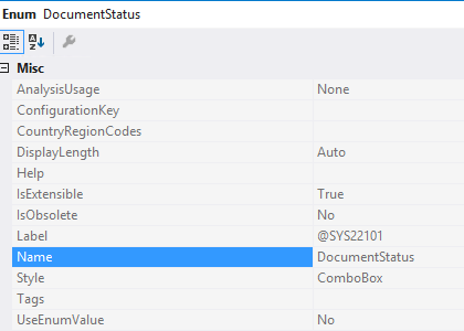

On BaseEnum objects there are some exceptions. To be able to extend a BaseEnum object, the ‘IsExtensible’ property needs to be true, which is currently set to ‘false’ in many of the system layer enumerations. And, if you define an enum as extensible, you cannot use enum values anymore (the property ‘UseEnumValues’ has to be ‘No’), which is a very unfortunate limitation. The integer value of the enum elements is not fixed if you define an enum as extensible (or use enum values set to ‘No’). In such extensible base enums, you cannot parse integer values into your enumeration variables, and cannot use greater or smaller (< >) operators as (priorityEnum1 > priorityEnum2). Moreover if you send your enum fields in a custom service, you cannot send or receive them as integer values. Hope in the future this limitation will be removed.
