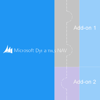

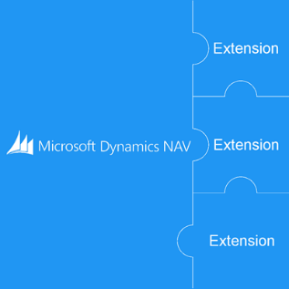

Extensions enable NAV Developers to modify live NAV environments without touching or customizing the core NAV system. A major benefit to Extensions is that they can be installed and uninstalled from your NAV implementation with minimal risk of breaking anything in the main application (code base). In other words, Extensions can be treated as apps for Microsoft Dynamics NAV permitting customizations without manipulating the original application objects.
Figure 1: NAV application with Add-ons                                 Figure 2: NAV application with Extensions

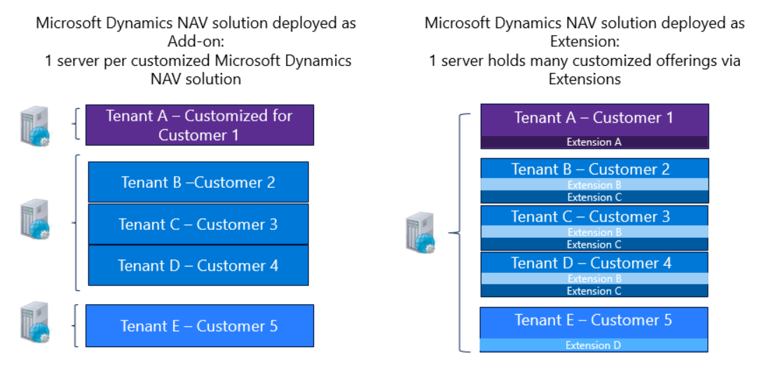

To deploy, you can publish Extensions in selected server instances and Extensions can be installed for selected tenants (see visual below).
Figure 3: Publishing Add-ons versus publishing Extensions

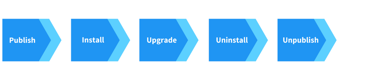

The Lifecycle of an Extension for Dynamics NAV
Figure 4: Lifecycle of an Extension
The lifecycle of an Extension for NAV 2017 is simple:
  • Publishing places an Extension package into a NAV server instance, but users can’t use it yet as it’s not enabled.
  • Install. Upon publishing an Extension becomes available for installing in tenants of a NAV server. Installing deploys Extension modifications to specified tenant of a NAV server instance.
  • Upgrading is simplified. Uninstall the old and install the new version of the Extension. All data transformations are handled in special Codeunits.
  • Uninstall removes an Extension so that the end user can no longer see or use it as it is disabled, but it is still on the NAV server. Admins can still reinstall the Extension. All Extension related data is archived and available to be restored when an Extension is reinstalled.
  • Unpublish physically removes the Extension from the system/NAV server.
