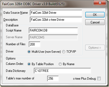

After installation, you will have a folder named OTREE of off your root (if you installed to the default location). Inside that folder is a file named faircom.db. This is a text file that documents the  path of the .dat files to the driver. It’s a simple format. Name the table something, space, and then put in the full path to the .dat file.
This is what my faircom.db looks like:
CN40102 C:\OTREE\DATA\CN40102.dat
OLFD_Tables C:\OTREE\DATA\OLFD001.dat
OLFD_Windows C:\OTREE\DATA\OLFD002.dat
IUHeader C:\OTREE\DATA\SY50000.dat
IUDetail C:\OTREE\DATA\SY50100.dat
The configuration of the driver itself (in Control Panel) looks like this on my machine. Notice it is a 32-Bit driver:
SNAGHTML2add23a
As you can see, you can name the .db file anything you wish, so long as you tell the system where it is located in the Data Dictionary field.

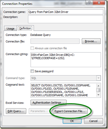

From there it is a simple process of using the Microsoft Query wizard to create a connection between Excel and the .dat files. You can even create an .odc file! You can do this from any connection you make, not just FairCom.
