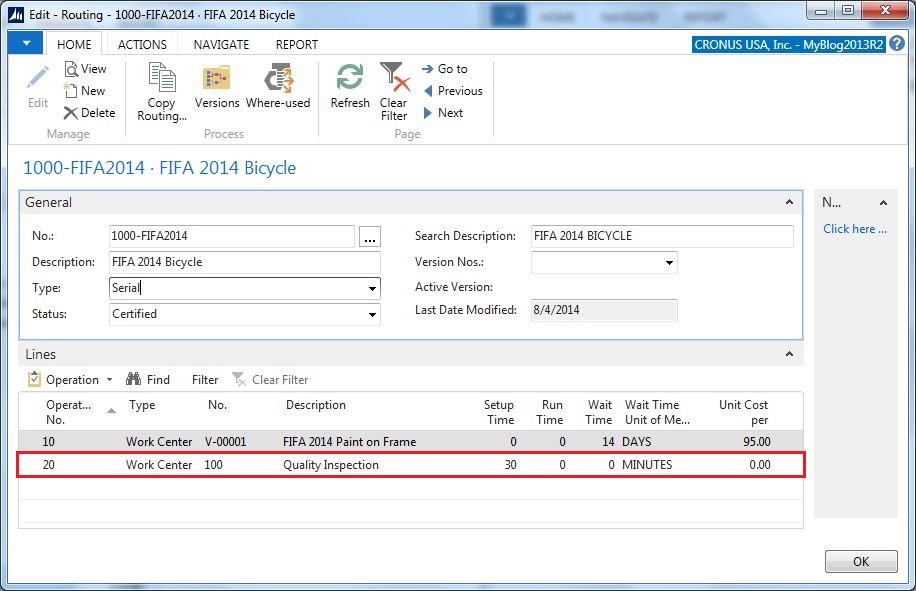

In this example we add a quality inspection operation of 30 minutes after the subcontracting operation.

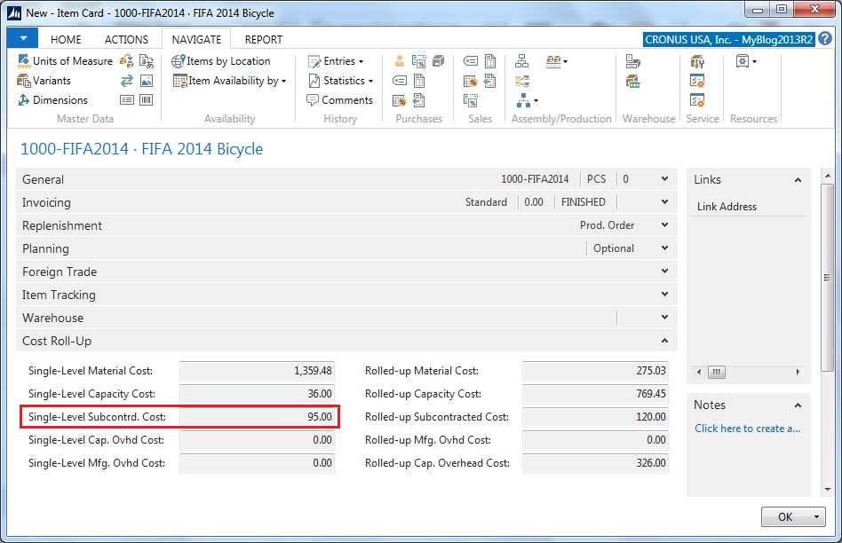

We then do a cost roll up on the FIFA 2014 painted bicycle (which is set to standard costing method) and we see the subcontracting cost in the Single-Level Subcontrd. Cost field in the item table (also described here).
Subcontracting-Cost-Roll-Up-Dynamics-NAV

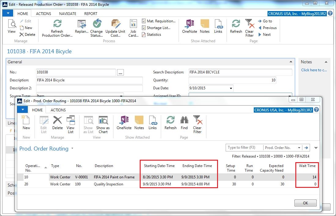

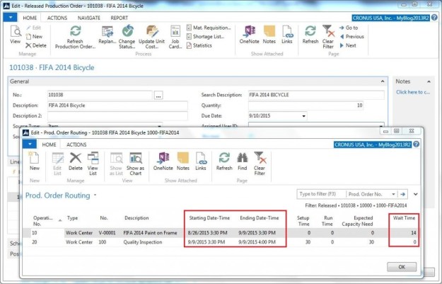

Subcontracting purchase orders are created using the subcontracting worksheet based on released production orders (yes they need to be released, firm planned will not work, sometimes a bit unfortunately but possible to live with). So, we start with creating a released production order for 10 PCS of our FIFA 2014 painted bicycles. We can on the production order review the routing to make sure the starting dates make sense.
We enter a due date on 9/10/2015, this calculates backwards and ends up with a starting date for the subcontracting operation on 8/26/2015 (which is the 14 days lead time for the subcontractor and the 1 day default safety lead time that is defined in the manufacturing setup). This is as expected.
Subcontracting-Production-Order-Routing-Dynamics-NAV
Note that the wait time can be updated on individual production orders if required (maybe larger orders takes more time for example).

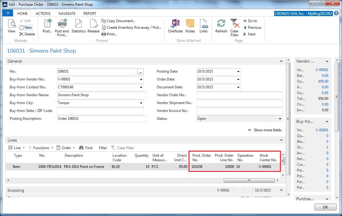

The purchase order that is created is a bit special compared to a regular purchase order. It has some references on the line to the operation in the production order routing (through the fields production order no., production order line no., operation no., and work center no.). The purchase order line has the item number of the item being produced on the line and an amount according to the cost defined in the routing (if not changed in the subcontracting worksheet).

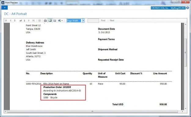

As you noticed, the description of the purchase order line contains the description from the routing. What I typically do is to design the purchase order printout to include additional data from the production order (when linked to one); for example can the comments behind the operation and the production order number be included. Sometimes the components to be delivered to the vendor are also included so they know what to expect to be received. This is easy since we have a reference to the production order on the purchase order line. It could look something like below.

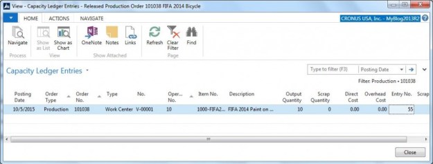

Posting the receipt of the subcontracting purchase order creates capacity ledger entries against the operation on the production order. If this was the last operation on the production order we would also get some output transactions of the finished product. In our case we still have the quality inspection operation left to complete before we get the product into inventory.

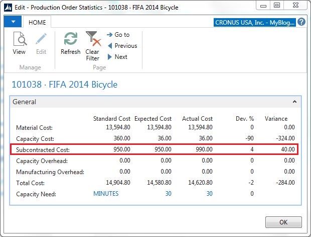

When looking at the statistics on the production order we can see that the subcontracting cost(s) are separated from the capacity and material costs on a production order. Note that I changed the amount slightly when I invoiced the purchase order (increased it from 950 to 990, forgot to make a screen shot of the invoice before I posted it  ).
