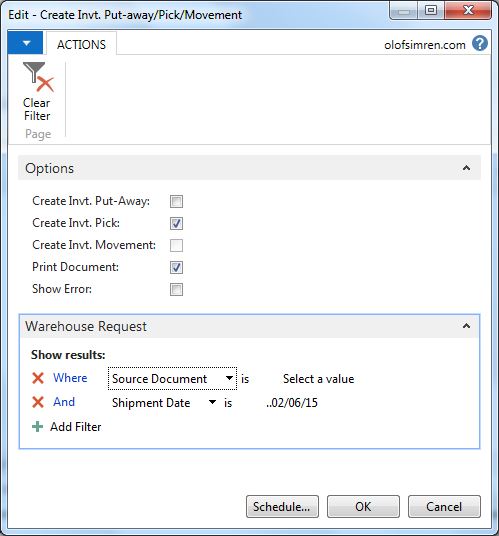

It also allows for Dynamics NAV to determine what should be shipped since the inventory picks are not created if the item is not available in inventory to pick. The typically way of using the inventory pick is to run the create inventory pick batch job a couple of times a day with a filter indicating how far ahead items should be picked (something like; create picks for everything that is available to pick that should be shipped up until tomorrow).
Create-Inventory-Picks-Dynamics-NAV
Note that the above filter on the shipment date applies to the shipment date in the header of the orders; if you are entering orders with multiple lines on different shipment dates then this might need to be tweaked a bit.
Dynamics NAV then goes through the released orders and if there is anything to be shipped within the date filter then an inventories pick will be created and printed if the item(s) are available in inventory. The employee can then just grab the picks from the printer and start processing them (and potentially use something like the shop floor barcode system to post it as picked using a scanner).
