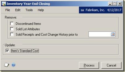

There is a function in the year-end close routine for Inventory Control (Tools  >>  Routines  >>  Inventory  >>  Year-End Close) that allows you to automatically adjust standard cost to the current cost for all FIFO Periodic and LIFO Periodic items.  This however does not allow you to select which items to update, what the new standard costs will be, and does not create a journal entry to revalue existing inventory in the GL; so really it’s useless.
YearEndClose

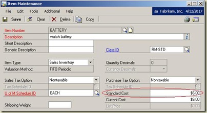

2)  Change the standard cost for every item you want to change.
StdCost

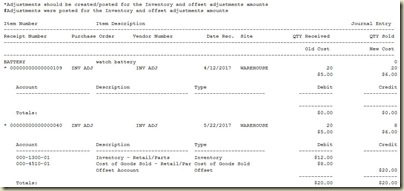

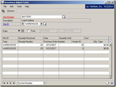

But what I would do, is take the alternative step of adjusting the costs by using the Inventory Adjust Costs screen.  Navigate to this screen:  Tools  >>  Utilities  >>  Inventory  >>  Adjust Costs
Select the items and enter the new standard costs for all receipts, and Process:
Adjust Cost
This will update the receipt records and print the information you need to create adjusting GL entries.
If you use the Purchase Receipts report for any of your reporting, you will want to do this step; otherwise the new standard costs will not be in the report.
