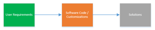

Consider a solution as a bucket of components. Components is customization's done based on user story / requirements. So each solution is basically a group of user requirements delivered to environments for QA and UAT testing and finally deployed to Production.

4. Ability to map and connect user story (requirements) to software customization's (components)

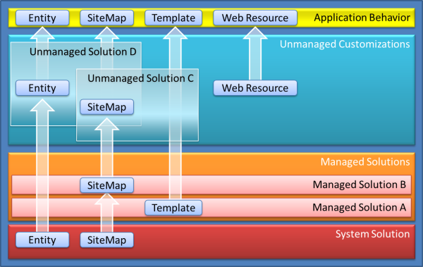

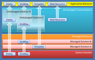

It is important to understand how Dynamics 365 will resolve conflicts. The figure below shows how the different solutions interact with the System solutions resulting in the final application behavior. The system solution is the default OOTB solution. Managed solutions and Unmanaged customization's determine what the user will finally visualize and experience.

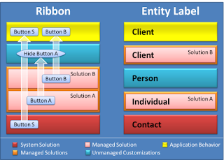

When there are multiple solutions Dynamics 365 will resolve conflicts using the two strategies – Merge and Top Wins.
1. Merge – All UI components are re-calculated and merged from bottom to top. The unmanaged customization are last to be displayed.
2. Top Wins – All other non UI customization's the conflicts is resolved based on the solution components that is applied last.
Update to a Managed solution does not follow the above rule.
If unmanaged customization's already exists for updates made to a managed solution, the user may not see the updated changes in the organization. The user will be given an option when updating the Managed solution whether to overwrite or preserve any existing customization's on top of the Managed solution.
