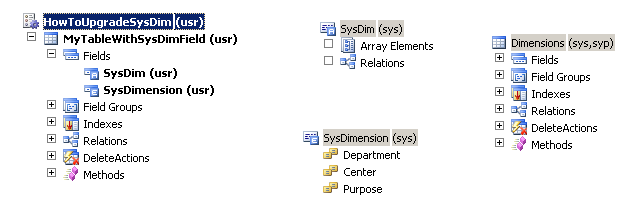

In AX 2009, you might have a field that extends SysDim extended data type (EDT) that represents a single financial dimension value. Usually it goes together with dimension type, a field that extends SysDimension enum.
Such a configuration is helpful when you need a single dimension value of any type (Department, Cost Center and etc.). By selecting a type, you restrict dimensions to be filled in the SysDim field.  It’s done by writing a custom lookup.

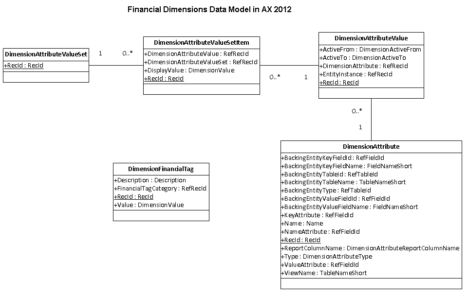

AX 2012 dimensions are referenced using RecIds, which can be difficult to understand. It first references a dimension value set. This set links to one or more dimension value set items. It depends on how many dimension values are entered. For example, if only department and cost center are filled in then the set will contain only two set items. Set items link to dimension values. Dimension values link to dimension attributes (dimension types) and to actual values. Referencing actual values offers the possibility to use dimension values from many tables, like customers, items ant, etc. Values that were stored in Dimensions table in AX 2009 are moved to DimensionFinancialTag table in AX 2012.

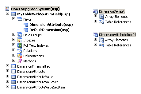

  1. Create RecId field referencing DimensionAttributeValue table.
  2. Create DefaultDimension field referencing standard set of financial dimension values and disable those that are not supposed to be entered.

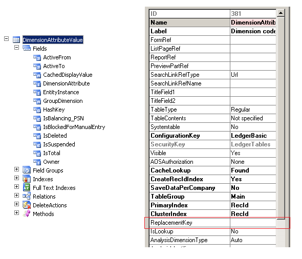

The first option might look promising but when it comes to displaying values on a form or a report, there is a drawback. DimensionAttributeValue table does not have a replacement key and so values on the field referencing to this table would be record id values, which means nothing to a user. In this case you have to create a field that would represent a value and make it as a replacement key. You have to make sure that a value is updated any time it is modified.

Then on the form you should see something like the following:
