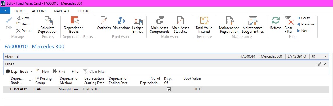

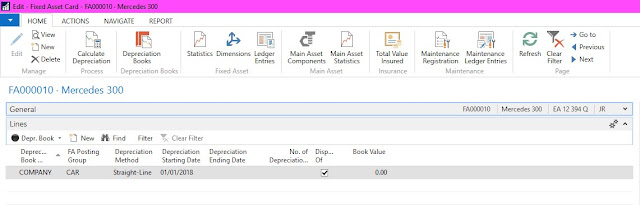

Above is the fixed assets which has been disposed & its book value has now been zero.

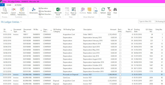

1. In the FA ledger entry find the sales invoice & navigate the entry.
2. After the navigate screen show the related tables where the entries have been posted,go to fa ledger entry & click on show.
3. After this you will see all of the fa ledger entries like with posting type as Proceeds on Disposal,Gain/Loss,Acquisition Cost,Depreciation.
4. Select the Proceeds on Disposal posting type entry & under function menu click cancel entries, click ok on the using posting date,you will receive a message that the entries have been transferred to fa gl journal.

After this check your FA card & you will see that there is no check mark in disposed and more if you drill down in the book value the entries related to disposal have been moved to error ledger entries.
