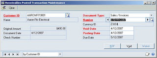

This procedure provides instructions on how to completely remove a sales order invoice that was posted and then voided through the Receivables Posted Transactions Maintenance.  (Transactions -> Sales -> Posted Transactions)

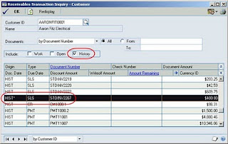

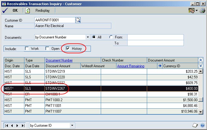

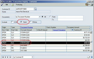

Verify the transaction under the Receivables Transaction Inquiry window (Inquiry -> Sales -> Transactions by Customer)
The invoice should be listed as an OPEN* and Voided transaction (as indicated by the Asterisk next to Open).

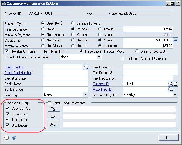

Open the Customer Maintenance window (Cards ? Sales ? Customer) and pull up the customer's record.
Click on the Options button.
 Make sure that all checkboxes are checked in the Maintain History section.  This specifies that Great Plains will move these transactions from Open to History and keep them rather than delete them.
The Paid Transaction Removal process will move the document from an OPEN status to HISTORY status.

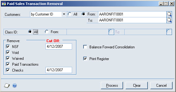

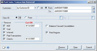

Open the Paid Sales Transaction Removal process (Tools -> Routines -> Sales -> Paid Transaction Removal).  Note that this process can only be run on the Customer, and not on a single transaction.
1.    Select the Customer ID in the From and To fields
2.    Leave Class ID set to All
3.    In the Remove section, the Void checkbox must be checked
4.    The other checkboxes can be checked if desired, but are not necessary
5.    Leave Balance Forward Consolidation unchecked
6.    Check Print Register
7.    Click on the Process button
8.    A "Remove Transactions" confirmation dialog will appear—click Yes
9.  Print the register to screen (and printer if desired) to confirm that the documents were properly removed
When this process is complete the document should have been moved from OPEN to HISTORY.

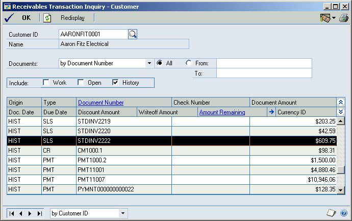

Now that the voided document has been moved to history, the Receivables portion of the transaction can be removed from the database.

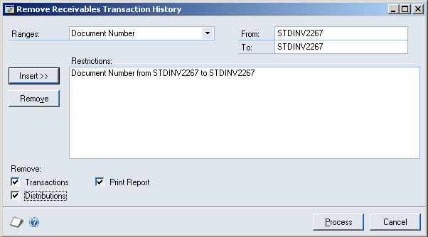

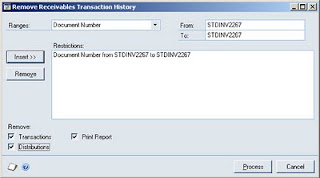

Open the Remove Receivables Transaction History window (Tools -> Utilities -> Sales -> Remove Transaction History).
1.    Change the Range to Document Number
2.    Enter the sales invoice number in the From and To fields.  Do NOT use a customer number.
3.    Click on the Insert Button
4.    Check all checkboxes at the bottom left corner of the window
5.    Click on the Process button
The document will no longer be listed in the Transaction Inquiry window.

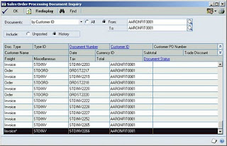

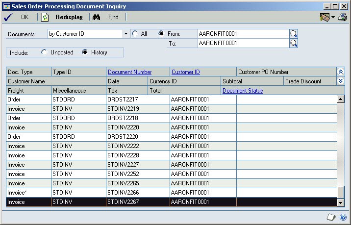

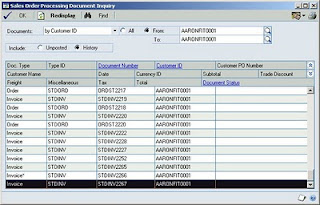

You can see that even though the receivables document no longer appears in the Receivables Transaction Inquiry window, you can still see the sales document in the Sales Order Processing Document Inquiry (Inquiry -> Sales -> Sales Documents)

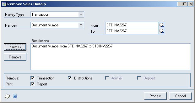

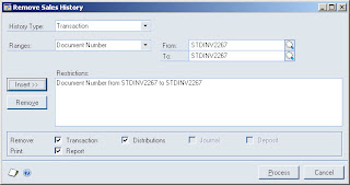

To remove the sales document, go to Tools -> Utilities -> Sales -> Remove Sales History.
Choose a Range of Document Number, enter the document number in the From and To fields and click on the Insert button.
Do NOT use a customer number for the range.
Make sure that all checkboxes are checked at the bottom of the window.
Click on Redisplay in the SOP Document Inquiry window and the document should no longer be listed:

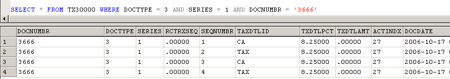

The above process removes all of the document records from the GP database; however, if sales tax is used, there are a few ancillary sales tax records that are not removed during this process.
This step must be performed by a Database Administrator.
Run the following select statement on the company database in question:
SELECT * FROM TX30000 WHERE DOCTYPE = 3 AND SERIES = 1 AND DOCNUMBR = 'XXXX'
(change XXXX to the RO number / document number for the voided invoice)
You should see two records for each SOP line item:
If these records match the voided transaction, they need to be manually deleted.
DELETE FROM TX30000 WHERE DOCTYPE = 3 AND SERIES = 1 AND DOCNUMBR = 'XXXX'
After this step is completed, you will be allowed to re-use the invoice number again.
