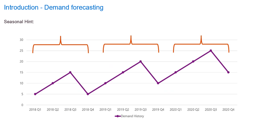

Seasonality can be one component of the forecast. See that there may be a seasonal pattern.The seasonality hint parameter allows us to tell the system on what interval we think our seasonality pattern repeats. E.g. if we have a quarterly seasonality pattern and we are forecasting in monthly buckets, we would put the value 3 in our seasonality hint field.
