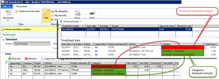

Some call it a “bug” – we think of it as an “opportunity” for improvement. Our team has recently encountered an issue in the "Project management and accounting" module particularly related to the "All timesheets" list-page, and we would like to share the resolution options with the AX world. This challenge seems to be persistent in all AX2012 versions.
The defect can be described in following manner: the category value displayed in the "Timesheet lines" info-part does not match the real value from the timesheet line.

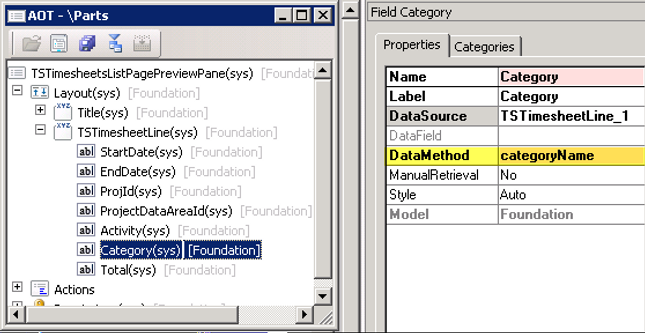

Analyzing the TSTimesheetsListPagePreviewPane info part we can see that values for some fields like "Activity" and "Category" will be returned by respective edit methods from TSTimesheetLine table:
Obviously, the method \Data Dictionary\Tables\TSTimesheetLine\Methods\activityTxt will be called prior \Data Dictionary\Tables\TSTimesheetLine\Methods\categoryName because of the order of the fields in the layout. These edit methods can act like "get" or "set" depending of the _set parameter. The parameter _set = false means that no changes will be performed against the values of respective fields.
