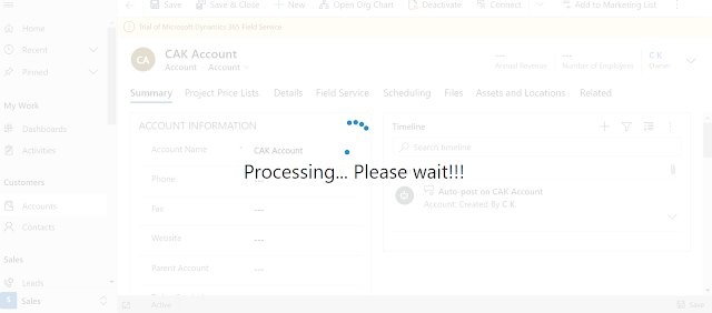

Of course you have faced a scenario where you need to block the user from interacting with the form and making him wait a little bit until a process is completed and then he can work again on the form.
However, blocking the user from working without informing him that something in the background is being processed is not a pretty thing to do.
Therefore, and to avoid this misunderstanding, you can display a loading dialog to inform him of this behavior, so he knows that he should wait a little bit before resuming the work on the form.
To achieve this, there is a straight forward method to do it, which is by using the Xrm.Utility.showProgressIndicator("Processing... Please wait!!!") method in the JavaScript.
You can add this line of code in any function, where you want to block the user from interacting with the interface while you are waiting for a process to be completed. Once the process is done, you can then remove the loading dialog and the user can resume his work on the form.
To remove the loading dialog, you can use the method Xrm.Utility.closeProgressIndicator().
The loading process dialog will look as in the below picture with the message you defined as parameter.
