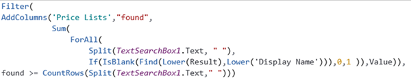

To do this, you need to use a slightly more complex formula that adds a new column to the Data Source. This column represents the amount of times the item is found by each word in your search box, for example if you search ‘student meeting room’ the item called ‘Meeting room for students’ will have a ‘found’ value of 4 as each of the keywords in the search were in the item's name. It does this by splitting the text by spaces and then checking if each result of Split() is in the display name, if it is then 1 is added to the new column. The Data Source is then filtered depending on whether the ‘found’ value is greater or equal to the number of strings returned in the split function.

In both examples you will note that Lower() is used on both the Result and the ‘Display Name’ this is so that the search is not case-sensitive, it is not required but does mean that users won’t need to worry about using the proper case.
